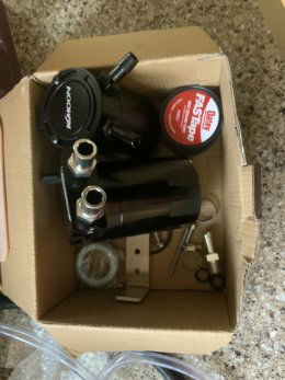

Hey so I was looking at doing a simple can system for now to at least maybe reap some benefits from having a can. And eventually ill have a full understanding of parts etc if this a,aging delete system you’ve created. Now, I’m not as engineerical in this same sense as making this thing look like it belongs on the bay And I’d like to be able to keep my cover intact. Anyway, im curious is it possible to just run a 1-in 1-out, can inline with the current PCV / intake. Or do you have to block Off the intake? Also, did you ever release a parts list or kit rob? Shipping to the states would probably be crazy, but I’m trying to see how inexpensively this can be done with a budget can. I feel like a can is better than no can (even if I didn’t buy a higher end can. I have two cans sitting at my house that I got $20 Ea and one is exactly the same as your small mishimoto.
if It is possible to run it inline with the OE system, you think you’d be able to re use the OE rebreather hose, I’ve tried to see if there are those quick connect ends sold separately since practically every PCV system uses the same end. So yea, if they are not sold separately, cut them off run a reducer between it and a new hose, going to the can - same process from can to intake. voila? this would all Involve placing the can on the intake side with the coolant reservoir .
idk maybe I’m grasping at straws. Also, I’m on stock turbo etc. no other mods, except replacing the airbox pipe with a PVC.
attached are pics of the two cans I have-

@Sketchmedic I'll take the liberty of replying here, I'm new here as well. I have 2.0TFSI and the few times I had the PCV hoses off and the amount of shi*e that's in them makes me want to install catch can and then decoke the engine, clean pipes and intercooler etc..
From what I gather so far, from reading this topic and countless others and "SHIRO-PCV-system-explained" on another forum, which helped me understand the PCV system due to illustrations (despite being technically minded I couldn't wrap my head around why does it need to pass under/inside the rocker cover, turns out it's jsut the VAG way), before I learned to understand the font > rear PCV and that the rear is basically just passage from the front I wanted to do 2 catch can setup because I was under the impression this is a separate circuit.
Yes you can add catch can inline with an existing system, and that is either before the integrated oil separator (the bump behind relief valve) and keeping the stock relief valve (no adaptation plate needed) or in place of the stock relief valve (you'd need the plate with 3 holes).
As others pointed out however it may be a good idea to verify that the PCV path doesn't have a leak inside the rocker cover.
