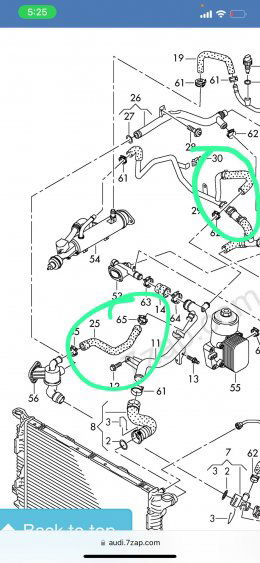

I have the same problem as you have on my Audi A4 B8.5 2013 CGLC.
I have changed:
1- 03L121111AD termostat
2- 1K0121113A one way termostat
3- 3W0122351 Non-return valve
I have found that there are two Non-return valve "check selected area 25 ". You can try touching this valve and you will see the difference after and before.
I haven't changed the other one yet. but I thought I'd share this with you.

Part number is another. I attached the picture! The valve is hidden in the pipe.
1K0121113A
3W0122351 (Facelift model) 2012-......
