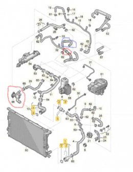

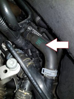

So finally I got it fixed and found out what's the problem of my car. The problem was with (Part number) 03L 122 157 M, marked in picture as Nr. 23.
Audi coolant system CAGA
Sadly dealer didn`t tell me important thing, that I got 3+ Thermostats, on the phone they said I got only 1. And after troubleshooting - that I can get the pressure check valve and thermostat of 03L 122 157 M separated from original maker,not from Audi,without buying all the hoses and stuff. So it cost me 180€ instead of 20€ for each of these units,or even less. Anyhow its fixed now and finally I can see 90°C in my dash.
Maybe someone will find this information useful in the future. Take care guys and thanks for the suggestions.

If I read your post correctly, you had your issue put down to a hose (Part no 23 in that diagram?).
I have read elsewhere there are several thermostats in the A4... not just the standard round one that everyone is replacing without much success.

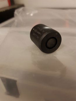

There is also a 'VERNET THERMOSTAT' - I will include a picture of this. From your diagram it looks like it may be part no 37? but I can't be sure.
DId the guy you speak to elaborate on any information on the location/nature of the other thermostats at any point?
Another question, where did you get that schematic from? It's very helpful.

for me it was the vernet thermostat as illustrated above. i;'ve been reading that 'it's normal for the car not to reach the 90 degrees' in quite a few places, but didn't believe this (i also have a A6 which heats up to 90 wihtin 5 minutes)... if the car doesn't run at 90, you will have problems with fuel efficiency, winter cabin heat and probably in the long run DPF issues.
anyway - I chanegd the vernet thermo, it was a complete b!!ch to get out and in (lots of awks bolts), but within 5 minutes of test drive after installation... BIIIINGO... winner winner chicken dinner.... the car reached and stayed at 90 degrees. thank god that's sorted. next to do an emergency DPF regen to clean that out...
Audi A4 B8 2.0 caha caga... All 2.0 diesel engine have two termostat and cooling valve.
1st Engine main termostat.
2nd termostat pipe termostat
factory number:1K0121113A
Valve factory number:1J0122351
Yes the two car parts have in the diagram (23 pipe number).
Facelift same but the valve of into a pipe. And another oem number.
Look at the pictures the google.
Write the oem number
1K0121113A
1J0122351
Do it!.
Best regards
Tamas (from Hungary)

where did you get this diagram from?
Hy!
Yes, number is 23! It have two parts! And I must be change main thermostat. (CAHA,CAHB, CAGA,CAGB,CAGC)
1K0121113A
1J0122351
All problems are solved!
However for the facelift model the temperature drop does not always resolve there. (CJCA,CJCB,CJCD,CGLC etc.
Part number is another. I attached the picture! The valve is hidden in the pipe.
1K0121113A
3W0122351 (Facelift model) 2012-......
There is always something fault with this.
There is a 50% chance of it.
Best regards,
Tamás!

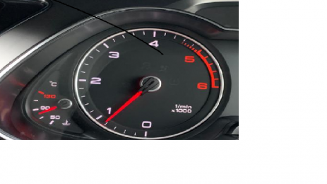

Hi,
I am having same issue with temperature as well it reaches 90 on gauge while on motorway but drops once you get off motorway heating works fine when facing up (windscreen) & vents but not in foot well.
Replaced few parts but still same issue its drinking diesel like mad (only does 400 miles out of full tank) independent Audi specialist who did repairs he gave up as well now is there anything else to look for and i desperately need the car for work due to high mileage every day.
(Audi a4 2013 tdi 2.0 cvt) not sure exactly what engine i have like caha or caga ...

I have attached an image after driving for 40 minutes most part was motorway soon got off the motorway it dropped to what it shows in picture and not giving me best mpg as well, if you recommend shall i ask him to replace thermostat again, by the way heating works fine as far as i know but does drops coolant temperature.
Thanks alot for your input really in need of some useful information.

Hy!
1K0121113A
1J0122351
1K0121113A
Best regards,
Tamás!
Hi Tamás
I have a 2011 facelift 2.0 TDI Audi A6 B7 with CGLC engine CVT gearbox
I have changed both (marked with red on photo) the main thermostat (03L121111AD) number 56 and the inline thermostat (1K0121113A) that has no number as it comes with the pipe number 32 (03L122157Q).
Coolant is still not warming fast only under heavy load or acceleration and even then if temperature is low outside it not staying at 90 degrees for to long after.
I have checked to see where is 3W0122351 on my car and from what I have noticed it is in the pipe marked with blue color again with no number attach to it as it looks to be part of the main pipe number 32 (03L122157Q).
Can you please confirm if is there? And is the 3W0122351 correct number for it? I am only asking this because I did not order the complete pipe number 32 (03L122157Q) to replace I buy the parts separate so the only thing that I am missing seems to be this non-return valve 3W0122351.

Hi John,
If you have this hose/valve, look at the top of your engine, above where the inline thermostat is and you should be able to see the one way valve hose. It's a small hose, about 6-8inch long and has a bulge at one end. It is also marked up with green writing and the product code 03L 122 157.
This is the hose that contains the one way valve 3W0 122 351.
