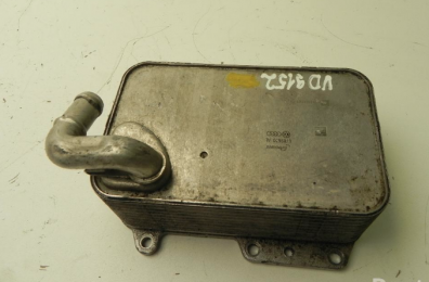

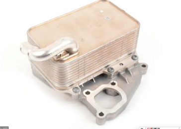

Another update on this, I put everything back together and found coolant leaking, but also some oil with it. Pulled everything apart again (only took me 1 hour to disassemble the second time) to find the oil cooler leaking. The problem was that the oil cooler is 2 parts- one is like a brick up top, and it's attached to a metal plate that screws into the engine block. Look at pictures of part number 059117015P to help understand.
I detached the brick on top for disassembly, and unfortunately I can't find a part number for the gasket that goes between the top and bottom parts of the oil cooler. Maybe Audi doesn't sell that, because both parts come as a unit for purchase and are probably not meant to be separated. So long story short, when you pull out the oil cooler, do NOT remove the screws holding the brick to the plate. Instead, remove the screws that are lower down so you can pull the entire oil cooler in one piece, like in this picture.

To reiterate, just do NOT pull the oil cooler out like this or you'll be replacing the whole cooler like me ($300 online, $450 at dealer)
