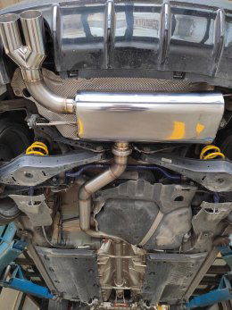

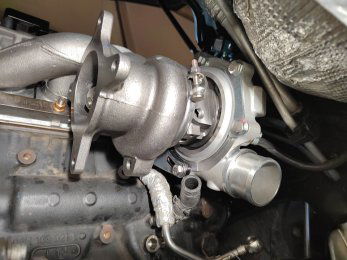

Well.

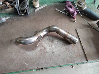

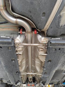

just installed a new turbo,full 80mm exhaust, new 90mm intake, and waiting for the second meth injector with the 9.5 lt tank from snow performance.
323384384 465766289087656 3205417742486804402 n325375498 5786960108054408 7316110876691692241 n325927886 977680146536976 4945747840445226212 n324445941 742828830769694 1220973037833048269 n324621406 953109215671423 5875247958325815276 n320967971 860135291967044 1975279956093556249 n 1327037694 486660130290691 1911570055304619225 n
Huge difference in sound and times an the road even without finetuning the ECU.
Exhaust very silent and almost without any drone due to the massive rear exhaust muffler
Intake 90mm alunimum mafless setup.
The sound is intoxicating

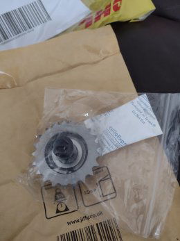

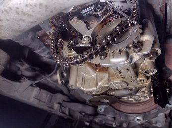

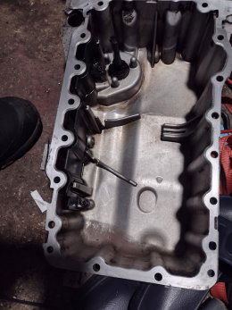

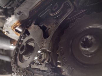

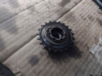

Did the balance shaft delete replacing the fixed wheel with the freewheel option.
It took a few hours as I also cleaned out the sump and changed the oil filter too.
Initial thoughts are is revs smoother and picks up quicker, not a night and day difference but noticeable. No undue vibrations and if anything it feels smoother and with less vibrations than with the balance shaft. Oh and the mileage is 189,430 miles.
Balance shaft sump removed cleanedBalance shaft freewheel fittedBalance shaft freewheelBalance shaft wheelBalance shaft delete

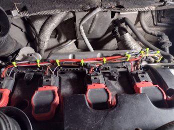

I finished repairing the coil pack wiring loom as the wiring insulation was so cracked I could see the copper wiring in almost every wire. My initial repair was insulation tape but today I replaced with new wire and then the joins insulated with shrink wrap insulation and 'pulled tight' with tie wraps before putting the outer insulation back.
I also replaced the pipe from the top of the fuel pump to the fuel filter as I ruined the sealing of the connector at the filter end, using 3/8 petrol approved rubber hose. I'm sure it was leaking under load, leading to stuttering and hesitation whilst driving.
Coil loom

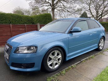

Another 25k on the A3 in the past year and another first time pass.
Since it’s first MOT in 2013 it’s never had a fail or a minor :)

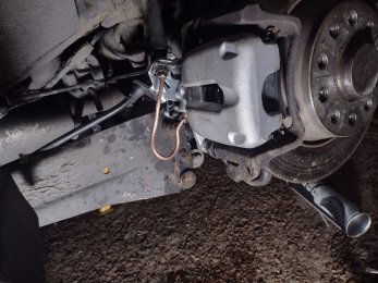

Passed the MoT but only after a fail due to ABS sensor and sticky handbrake.
First ones ordered from eBay were the wrong ones, second paid from Amazon fitted but I had to file them down (Chinese copies and will be sending back) first and once fitted code still showing fault. Then bought two more Cambiare branded ones which cleared the code and worked. DO NOT BUY CHEAP ones no matter what.
Secondly I realised both calipers couldn't be wound back and on the near side the pad had worn almost right down to the backing plate where the caliper wasn't retracting and had damaged the pads. If I had more time I would've bought the refurb kit as I've done that before but wanted it done to pass the retest so bought two new, non oem ones and will refurb my old ones later to put back or sell on.
Also had to replace the brake pipe linking the caliper to the hose and both sets of brake pads. Not particularly difficult, just need to ensure you use the right tools, bleed the brakes properly afterwards and use water on any dripped brake fluid as it's corrosive. What a difference to the driving experience, those brakes must have been binding since I bought it six months ago as the chap said he had had new discs and pads fitted all round. I suspect they were fitted due to the iffy calipers and this was a 'quick fix'.
Annoying my CP Racetec braided brake hoses turned up this morning as I wanted to replace those too, but will do so later tonight

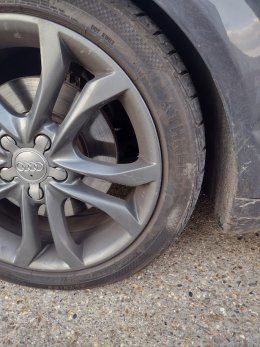

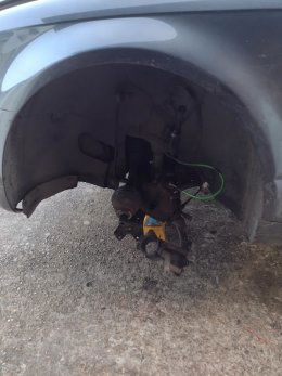

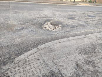

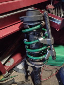

Hit a big pothole and damaged the front passenger shock so replaced with another B4, replaced the front wheel bearing and also the wishbone and a polybushed one from eBay. Much better, just need to replace the drivers side wishbone then look to polybush the rear suspension arms in the coming weeks.
Will be contacting Harrow council to make a claim.
Frustrating as I only replaced the shocks a few months ago and this time it was such a pain getting the shock to seat properly in the hub knuckle, even using a spreader and lots of grease. Had to leave it overnight, apply pressure with the trolley jack under the ball joint and a cold chisel and hammer to help spread it and even then this still took me about an hour to just do this part.

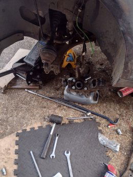

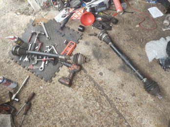

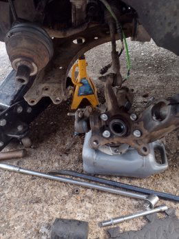

Replaced the drivers side driveshaft due to split gaitor and outer tie rod end which has reduced some road noise whilst driving.
Also replaced the rubber hose between the purge valve and inlet manifold
Replaced the charcoal canister and the hose as I worked out the one way valve was now two way between the canister and return feed to the petrol tank.
Replaced the fuel cap as it wasn't sealing properly and now no longer get strong smells of petrol
Topped up the air in all of the tyres as all about 2-3 psi down on recommended pressures.

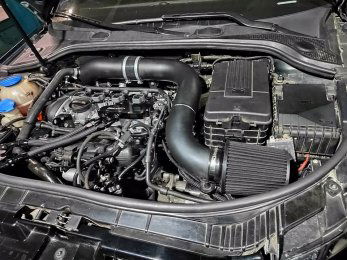

Picked up a Pro ram oversize intake for a bargain and fitted it. Sounds the nuts now with the turbo whistling away on boost.

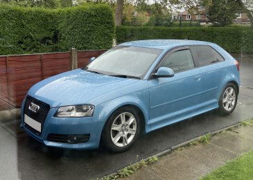

Finally got around to fitting my new honeycomb grill which has been in my shed for months, whilst I’ve been working. Such a lovely upgrade even if it took an entire day to strip down the front end of the car, clean everything up, paint the crash bar and re-install the new grill etc.
I painted up the front parking sensors black as they were grey from the original grill. Now they seem to be constantly going off and I’m not sure if it’s the paint or how they sit in the new grill… Investigations needed. Anyone else had this issue?
Car looking great. Can I ask what size / make tyre you have? Look real beefy, love that
Haha! They’re actually just really cheap 205/55/16’s with the stock alloys. I wasn’t going to replace them as I want to upgrade to 18” wheels soon.
