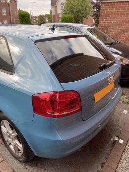

So this is month two of owning my first Audi (and being on this forum). Absolutely fallen in love with it and have lots of plans. It's the 2.0TDI (170) so not too much i'm willing to do on the engine, remap at some point. This month i've mainly been fixing and tidying up the car from the previous owners. Had some valeters come round and do a full detail on the car just to get it clean and sorted, starting fresh etc... Some other bits i've done below;
Windows tinted
New rear washer jet (old one was blocked)
New Bosch wipers front and rear
Dynamic LED mirror indicators installed (Canbus friendly)
New inner door seal, drivers side (old one was torn and, well, old)
Replaced cigarette lighter with fast charge USB3.0 and voltmeter
Ashtray delete with tray (I've ordered the light bar etc for next week)
New brake discs and pads on the front
New number plates
LED number plate bulbs (canbus friendly)
LED interior light pack (canbus friendly)
LED DRL bulbs (Canbus friendly)
Oil change
New pollen filter (OEM)
New air filter (OEM)
Debaged the rear (kept Audi rings)
It's into the garage next week for a knocking sound from the from suspension. I want to upgrade to coilovers soon but was hoping to leave it a month or two... I'll post some pictures soon :)
I do want to upgrade the headlights to bi-xenon (with the DRL strip across the top) at some point... So if anyone has some units (with bulbs/ballasts) for sale over the next few months, let me know!
Such a great platform here with so much helpful advice! Thanks to everyone :)

Fallen head over heals with it! Especially that big back end!

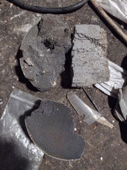

I removed the downpipe from the car just enough to hammer out the pre-cat over the weekend. By this I mean it was still on the car but angled enough so I could knock out the pre cat material with a hammer and large screwdriver and have it fall out onto the floor and not into the exhaust to clog the cat. Heavy rain stopped play Saturday evening, so finished it Sunday, still in the rain but not as heavy and since most of it was underneath the car, I didn't get too wet. On a dry day and removing the 02 sendo
If I was to do it again, I would remove the O2 sensor first before trying to slide it out from underneath the car, a schoolboy error I blame on the weather... I've attached some of what I knocked out, the rest was in very small fragments and dust. It is essentially a very small honeycomb material designed to help the main cats warm up but it's not tested here in the UK so not needed.
My previous car was a Golf GTI stage 1.5 which I fitted a 3 inch downpipe which allowed it to breathe and run so much better, this is a more noticeable difference, probably because this engine has almost 190k mileage so I don't want to spend too much on it. A definite mod worth doing in my opinion as it is one you can do on your driveway ( I did) and it's essentially free as you can use the same gasket and bolts. In driving terms it's like a mild remap on my car OR if I'm being skeptical like it only has 19k miles on it and has been nicely run in. This will work on all models with the pre cat but can't comment on diesels as I don't know if they have one.
On a dry day and removing the 02 sensor I think I could do this in under 2 hours, but this weekend I think it took me about 6 hours in total over the two days.

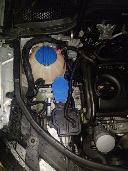

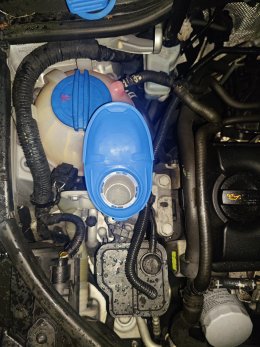

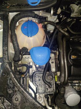

Fitted a washer cap used from the newer skodas. The design is a funnel, making easier to pour water in. Bought mine from aliexpress for 3 quid, but genuine isn't much more. Part no. 6v0955485
