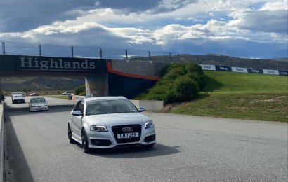

I thought I’d add an update to my post from 2017 - the buzzing at 1800’ish RPM that Audi couldn’t fix (but three parts at the car) - it’s been getting worse recently and more so after a couple of laps at a local circuit. put it on the hoist and there is a heat shield above the drive shaft shielding from the turbo - this was missing a nut. We fastened this and the buzzing and annoying rattle is all gone. It’s amazing how solving small problems make the car fun to drive!
