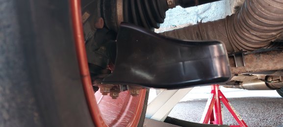

Decided to add some RS3 brake ducts to the front to increase airflow to the discs.
Audi part numbers 8V0407811 / 8V0407812

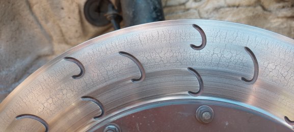

First took the car for a run out to get a baseline on brake temperatures, It's hard to get a lot of heat into brakes when not on a track especially when they are as big as the BTCC setup is. As it is difficult to repeat exactly the same braking pattern between runs I decided to make changes to one side only and see what difference that made compared to the unaltered side. Front disc temps were in the 180-250 degree range and rears around 75-100 degrees.
So I expected the temps on both fronts to be similar within a few degrees. After 2 runs I discovered the gearbox side was around 25-30 degrees hotter than the engine side based on temps around 210 degrees on the gearbox side and 185 on the engine side.
The rears were pretty much identical on both runs.

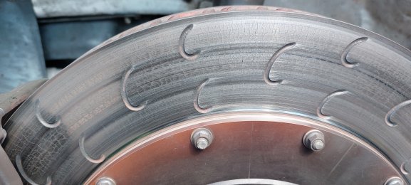

Confused I looked closer at the setup and comparing pictures of the discs you can see there is more crazing on the gearbox side disc and the anodised centre is more discolored so this has been running hotter.
Hotter gearbox side
Hotter gearbox side disc
Cooler drivers side disc.
Cooler engine side disc

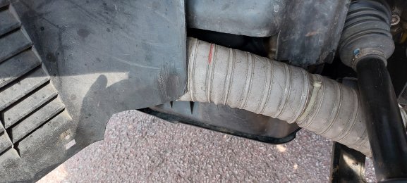

Looking at the brake cooling hose, when I fitted the DSG box it is a little longer than an 02M and the hose had been flattened a little so it didn't foul when the slicks were run on the wider rims. There still looked to be a good amount of area in the hose for flow ,but this is obviously having an effect. so could be just one disc has been running hot causing the problems.

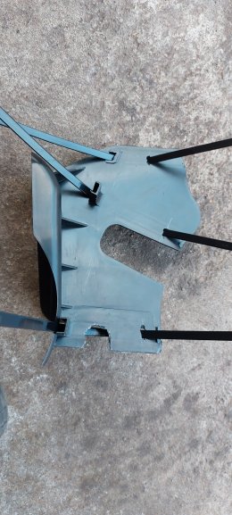

Fitted an RS3 duct on the engine side still with the front vent blocked and the engine side brake disc was now about 5 degrees cooler than the gearbox side. So still 20-25 degrees hotter than if the front duct was open.
Modified duct
Modified cooling  duct
20250512 114350
So from my basic testing the RS3 duct is about 50% as effective as the much more complicated front mount duct with hoses and plates for the hoses to connect too.

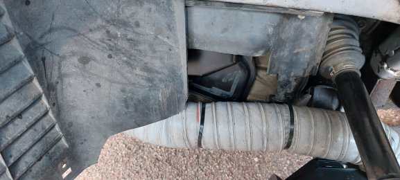

I revisited the hose on the gearbox side and altered the routing so it was mounted lower down, meaning the hose did not need to be flattened.
I took it out for a blast and did my best to get the brakes as hot as I could and succeeded with more high speed stops, and brake temps were now within 5 degrees of each other across the front.
Modified cooling hose path
Modified gearbox side hose routing
Original flattened hose.
Original gearbox side hose routing
