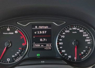

I can confirm that auto hold works by only using the adaptation channels, but the green light won't work. Coding is therefore needed.
ABS Coding original (A3 8V 1.4 TFSI COD Manual):
13F16AA224232A6C017D060141CC29C856245480608294F2022100788608
New coding (Now with Auto Hold):
13F16AA224232A6C037D060141CC29C8562454C0608294F7024300788608
All you have to do is follow #56 and #64.
Photo 2021 11 05 13 57 48

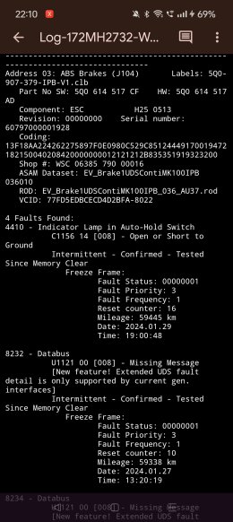

Hi all, pulling my hair out here, trying to do it without the button. I do the coding changes 8,19 and 23 then do the 3 adaption as per the video, then I get auto hold unavailable and the this fault error - 4410 - indicator lamp in auto-hold switch c1156 14 [009] - open or short to ground confirmed - tested since memory clear, any help would be greatly appreciated
