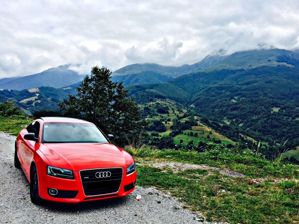

Hi ALL,
My name is Beni I am from The-Netherlands. Having a great hobby what is cars specially VAG Cars :) We have a own group of friends called as team (bro-performance). (All just for 4 FUN) :busted cop:
After many months of reading :readit: here on this fantastic FORUM, and allot of great help from forum members @desertstorm @bobbysigh I thought let`s open a new thread of my car. I love to take part in drag racing 1\4mile and want to set a own personal record with this car soon I hope.
Went for a AUDI A5 3.0TDI color (Misano Red) engine code (CAPA). I already have done a couple of modifications on the car :
90MM downpipe
76MM Exhaust system no silencers 100% straight pipe
EGR delete + EGR Cooler delete + EGR Flap delete
Swirl flap delete + Intake Manifold Flap Actuator Motors LEFT+RIGHT delete
Bigger air box intake 85MM + Pipercross filter +Butterfly flap delete
Darkside Intercooler
Audi A5 Facelift S-LINE rear bumper + Rieger RS Diffusor + RS5 OEM TIPS Black
More pictures will follow.
