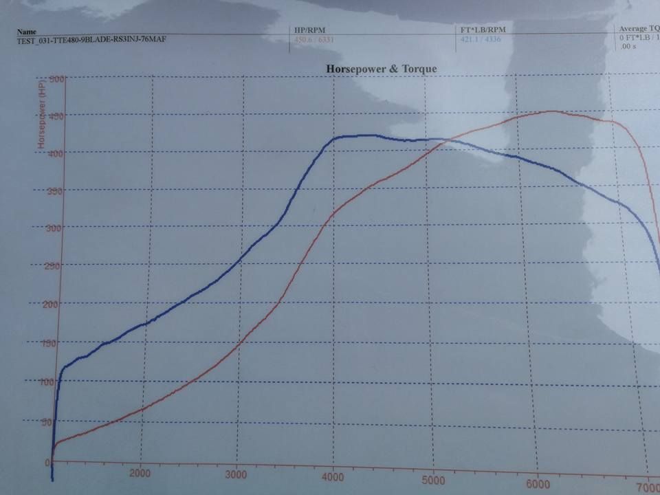

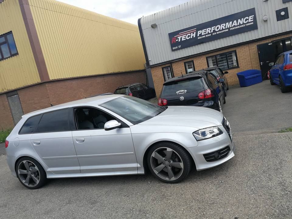

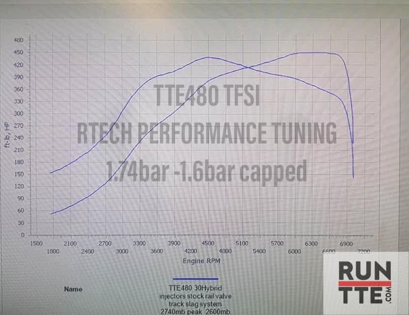

One of the first TTE480 9blade results from
The UK tuner R-TECH
Audi S3 8p 6mt TTE480 9 blade on a stock CDL engine RS3 8v Injectors with AKS development head modification to allow perfect cold start and cleaner combustion like the stock Injectors. Peron FMIC - 100cell Sport cat - Revo intake with 76mm id AKS MAF tube.
Car setup for durability while on the stock engine...
Car was built & prepared by AKS Tuning
450HP 420FT 98ron (no wmi) stock engine. (456PS 637nm) Car will do more when forged engine is fitted

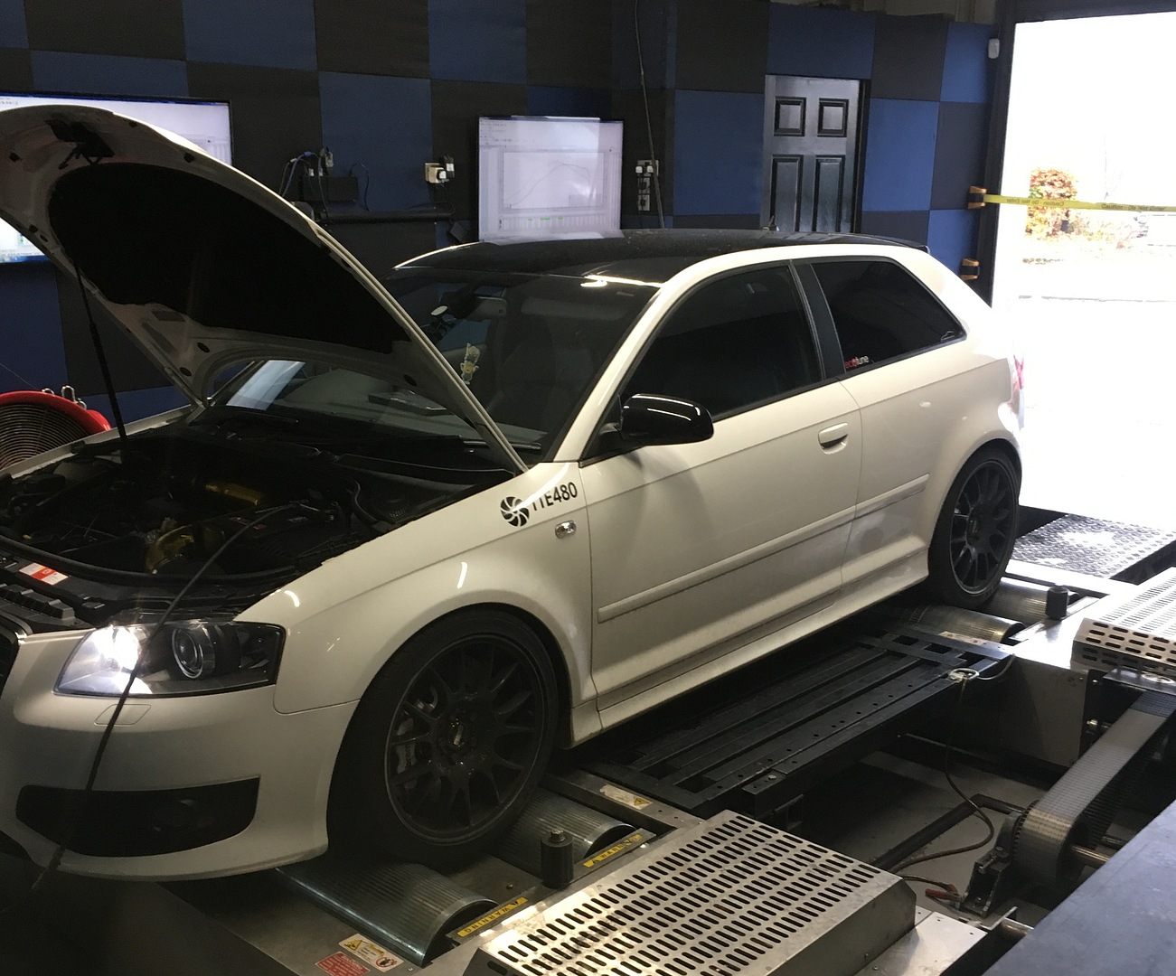

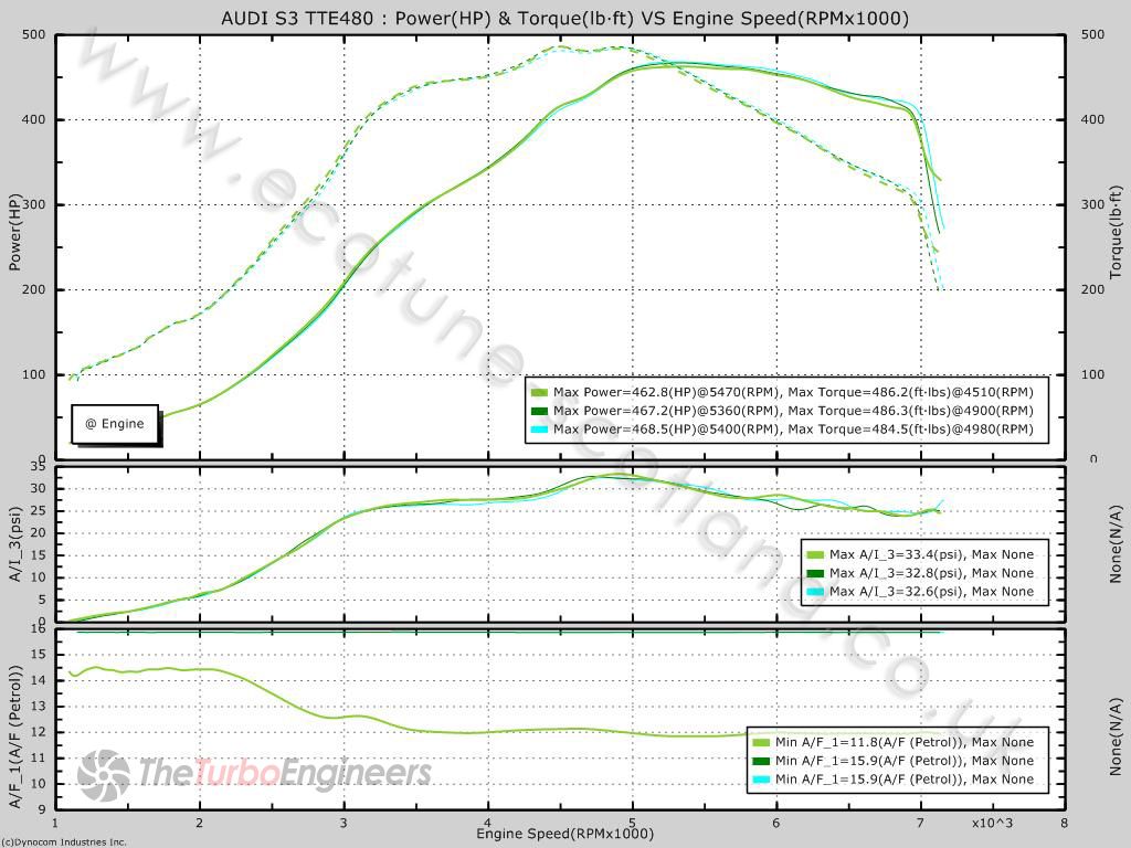

Result from the guys over at Ecotune in Scotland on James AUDI S3 8P 2.0TFSI
Spec list below:
TTE480 Upgrade Turbo
APR, LLC. HPFP
TTRS LPFP CONVERSION
APR DOWNPIPE + CUSTOM CAT BACK
AIRTEC INTERCOOLER
NEUSPEED DISCHARGE PIPES
RFD
98 RON Fuel (NO WMI)
ECOTUNE Custom tune
474ps 655Nm
Hi this dyno are wheel hp or engine hp thank

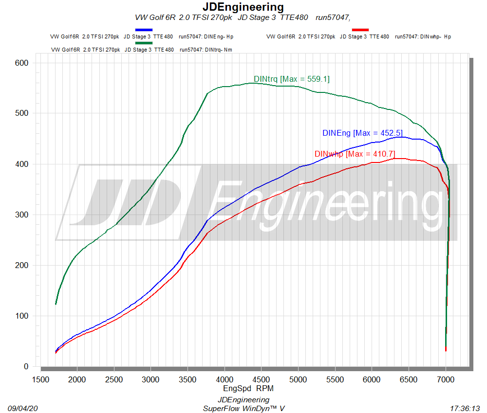

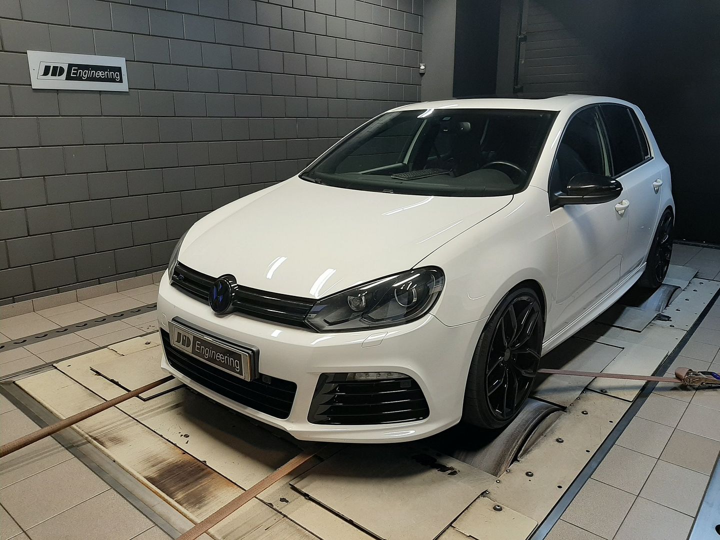

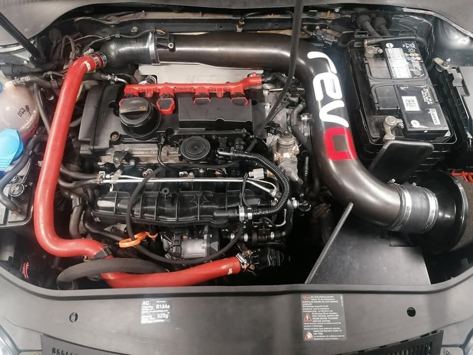

VW Golf 6 R 2.0 TFSI 270pk 4-Motion
OEM Specs: 270pk & 350Nm
JD Stage 4: 452pk & 559Nm
Specs:
TTE480 Turbo
Full exhaust
Wagner Intercooler
VW Racing Intake
Big injectors
Autotech HPFP
RS3 Tankpump
165 bar fuel rail valve
Runnerflap delete
Walnut blasted intake
GFB DV+ (diverter valve)
JD Stage 4 software
JD DSG Stage 3 software
100ron fuel (no wmi used)

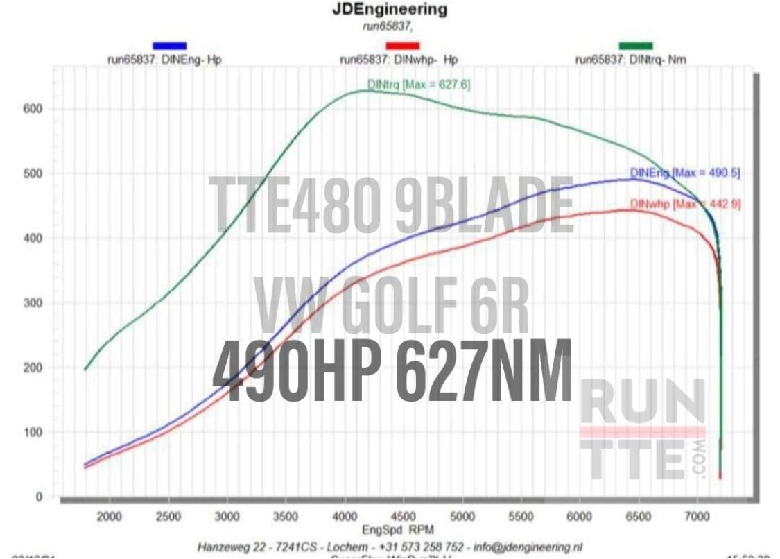

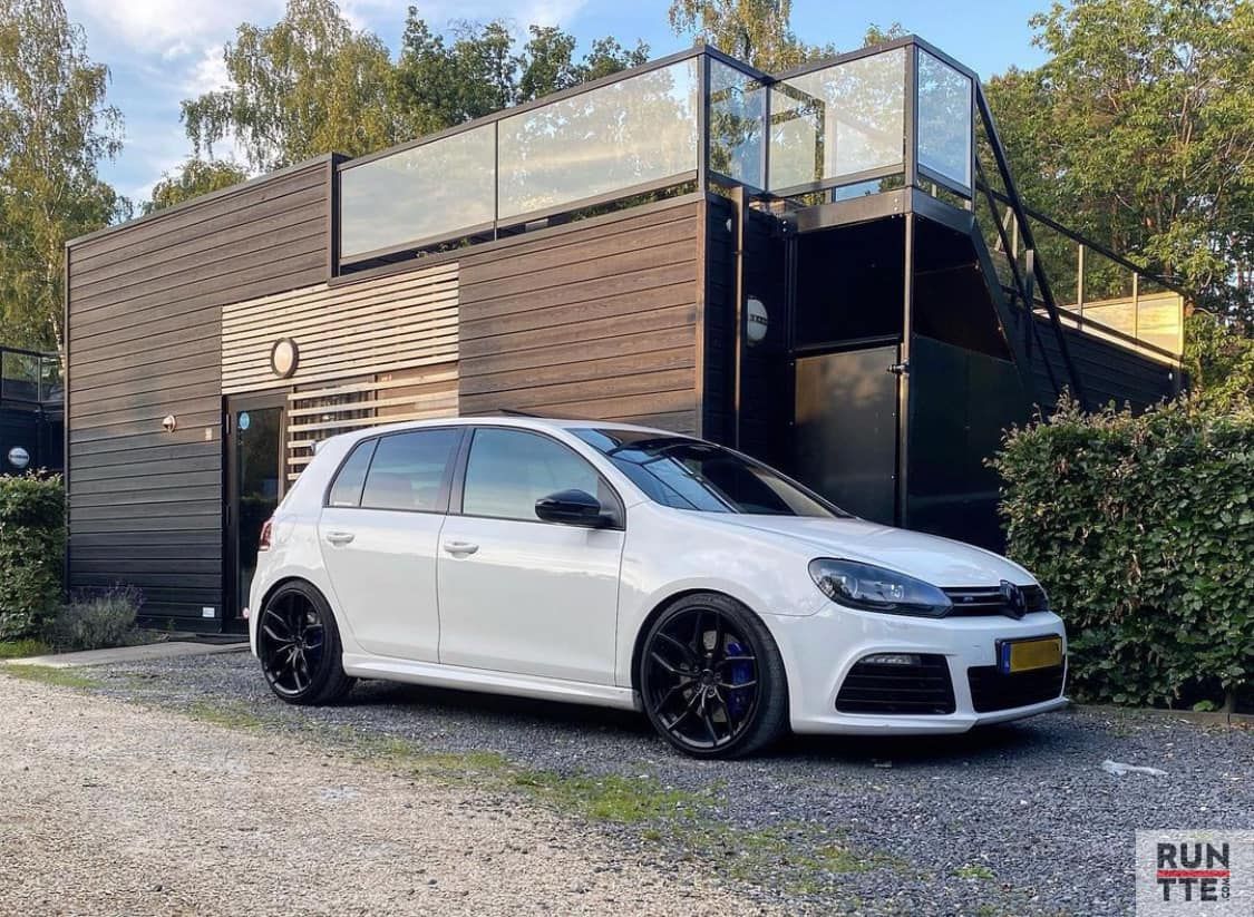

Dylan’s monster VW GOLF 6R TTE480+
Instagram: Dutch.mk6r
490HP 627NM tuned by JDE
