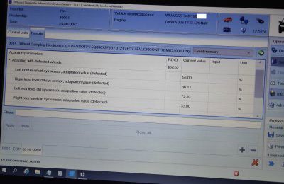

So I asked them to ODIS the car anyway and managed to capture this screen, they have no idea what to do with it and me too lol..
I have read the the whole post from page 1 to 5 and yes I realised you have mentioned vastly different adaptation procedures between magride and valve system.
Anyway here is a SS from ODIS, rear adaptive damper from my car (RSQ3 f3 83A512009) and also another one from Tiguan allspace (5QF512009G) just for comparison sake.
The tiguan owner lowered exactly like mine using KW -3cm front, -4cm rear, and he described the same thing.
Thanks again for your valuable inputs

as explained in the other post, technically the control module needs to know certain information in order to perform as intended. It gets this information by way of a calibration. The level sensors let the control module know how much lower or higher the vehicle is from the calibrated baseline, which at the moment on your vehicle is incorrect, so all calculations are going to be incorrect. The current ride might be ok for you, nothing wrong with that but technically the system is not going to work as intended. Track the vehicle or show it some fast corners etc and you might start to experience throttling and other unwanted side effects because the control module thinks the vehicle might be about to bottom out or maybe come off it’s dampers. I remember the automotive addiction club sport mk7 had this issue at Spa, dave Henderson’s RS3 had this at pod and crail, same with Aoon’s PFL RS3, Dave7R’s DAZA m7R also. Once calibrated the vehicles behaved themselves and no Christmas lights on the dash. Actually the club sport was solved by bending the level sensors as they did not have the correct interface trackside for me to remote in, and the DAZA DCC was coded out.
not sure what else to say. You asked if you needed a calibration, technically yes but if you are happy with the way the springs are working for you then it’s all good :)
