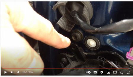

I replaced the window regulator at the weekend and when i put it all back together i noticed i had this wind noise at 60mph+ , i have noticed the top of the frame by the B post is sticking out slightly.......i have read somewhere that there is a adjustment screw in the door .....there must be a simple explaination as it wasnt there before i did the work......its a 08 TDI A3..............i did see that there are adjustment bolts/screws at the bottom of the door on TTs...to adjust the height of the glass.......... i have a feeling the adjustment thing is a 30 torx near the hinge side of the door...... will keep informed as too cold to fk about with cars today.
Loosen the bolts for the regulator/ frame frame, overly extend it towards the car and have someone hold it there whilst you tighten the bolts.
wgen you close the door it will move back sufficiently
got a feeling that this was the bolt used to adjust the frame.....you remove the bolt and adjust the part the bolt goes into using an allen key.......havent tried it yet but this was on a utube video i watched and was only fleetingly mentioned.....but surely Audi techs would know this??? .........dont shoot me if i'm wrong tho :flushed:
good idea.....will try that as well..........just gotta get in the mood to take it apart again ........was a bit of a pain in the ####

sorry i didnt get back earlier as been fkin about with my car for months on other issues..... the wind noise problem.....i adjusted that screw i showed above and it fixed the problem,i think i loosened slightly a few screws that hold the regulator to give it a bit of movement......anyway i hope this helps :thumbs up:

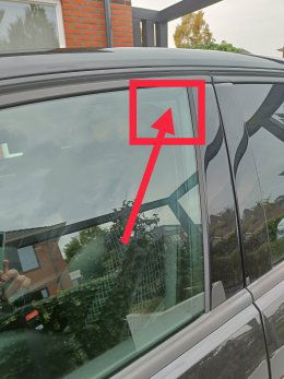

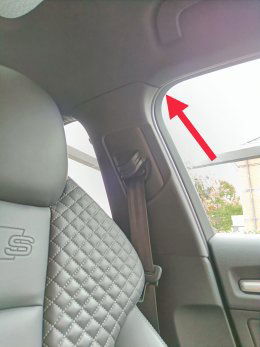

Since a couple of weeks I notice wind noise (speeds above ~50mph) from the location/red arrow in my attached photos. Drove my facelift A3 E-Tron since 2018 and it always was completely silent... What could be wrong? Is this the same problem as mentioned in the TPI? Are TPI's free on a 2017 A3 without warranty? What can I do myself?

I've read the TPI and this is exactly my problem. I tried to tilt the window angle backwards while slowly closing the window, and because of the better tilted end position the wind noise almost completely disappeared. Until I automatically open and close my driver side window again...
The pictures in the pdf in this topic aren't detailed/sharp enough. I can't find out what is seen in picture 2.
Is there a better pdf/better copy?
Hope to do the needed work, mentioned in the TPI myself, because I'm out of warranty and I think TPI's aren't free ...
