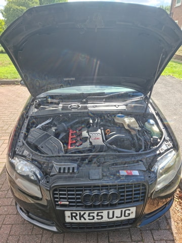

Washed the car after i replaced the front inner bumper and added a scuttle cover. Finally, the front bumper is sitting where it should.

That all said the battery cover is on it's way today and it'll finish the scuttle panel cover up quite nicely. I might just recondition the panel so the new battery cover and the panel are matched colour wise.
But that something for another day... just like the new injector seals I got for good measure
I also looked at missing bonnet liner and the missing engine cover rubbers.... I ordered the engine cover rubbers so that'll sit completely secured soon, but i haven't found the bonnet liner yet. Well i'm saying it wrong, I'm looking for the bonnetliner with the mounting stuff as that isn't on my bonnet at all. It's either been removed by one of the previos owners because it was ripped, or never had it as the mounting holes are there but are clean like there never was anything in them...
anyway, I'm looking for a new bonnet liner with the mounting hardware... I'll find it eventually.

And the bonnet insulation just arrived with it's fitting hardware... all in all, it took me 10 minutes to clean the inside and put it on.
Looks so much nicer under the bonnet now.
