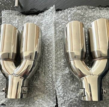

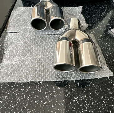

And I finally decided on the exhaust tips mainly these came at such a bargain i couldn't say no... i'll put up some pics when they arrive. it's a style i didn't even consider until i spotted them. Will be nice and will let you all wait until i get them delivered.

They look great, but I hate to be the bearer of bad news, they may not work as expected.
Reactions: northpole
OE B7 2.0tfsi rear boxes have a central outlet position as per pic, but depending on which valance you are using and from which variant, the cutout can be offset, so you will need offset tips.
This is the S4 valance, and the positioning is clearly offset.

And i checked it and they might work but chances are i'll go single tip, most likely the carbon style. Something about having 4 pipes poking out the back doesn't sit right with me... it's the 2.0 slow so not turbo power to match the look.
