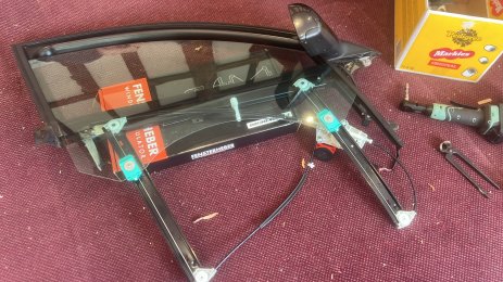

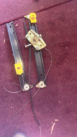

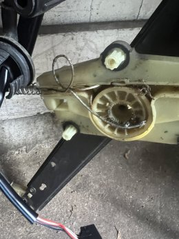

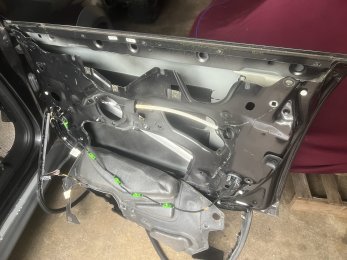

Had the dreaded drivers side window regulator cable snap on friday evening, exactly the same format that I had with thd b7 , even in the same place , still had a replacement arrive yesterday and fitted today, definitely easier than doing the b7 as the mirror can be left on and less door seals to disturb, still a good few hours work though.
Done now and all good on the old barge.
Fitted a new master window switch too.
