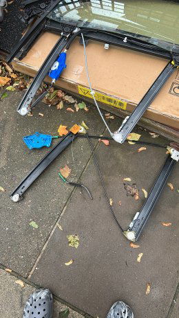

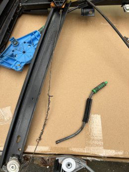

Sorting the window reg
Reactions: northpole, B7Tourer, Matt275 and 1 other person
Having done 3 out of 4 on my old B6, that is definately a familiar task. I dreamed they had improved the design by the B7 or at least the reliability of the part!
