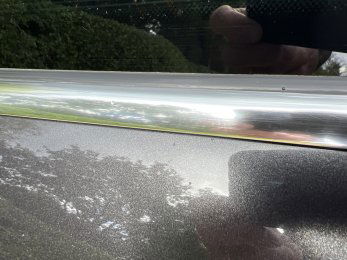

After years of putting up with the faded and watermarked brightwork around the windows on B7 and with no real sucess, I may have found a solution.
My allroad is also afflicted to a similar degree, so ive been experimenting today with different methods.
Reactions: northpole and Matt275
having tried everything in the past inc wd40 that works great for 10 mins..lol
I had some maguires all metal polish paste , applied with a scotch bright pad using soft light motions , then buff off and use a sealant of choice it does the trick really well.
will whack up some before and after pics in the morning , why i didnt try this method before i just dont know.....

Brightwork comparison.
Better by miles.
Better pics
A massive improvement, still , a bit more than acceptable now. :yahoo:
