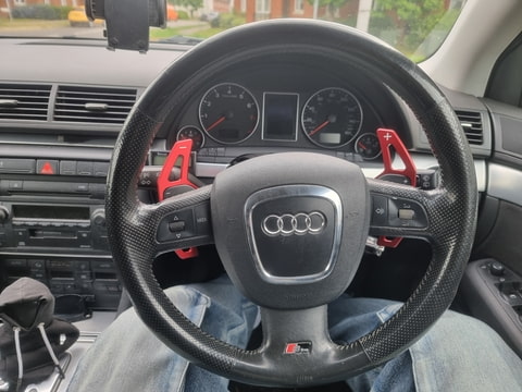

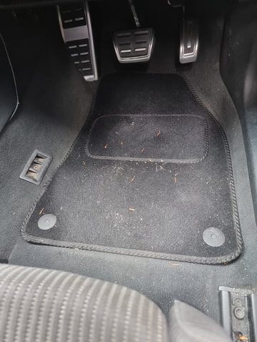

Flappy pedal extensions have arrived and are installed... no pictures taken as I forgot to take my phone with me.... mweh will do that another day.
Also s-line pedals have arrived but haven't got around to do them yet... as the lot needs to be modified to fit properly. Will need to get some 3m double sided extra strong tape to make sure the lot stays put once I reshape the bits to make it fit like it came out of the factory like that. Only one that goes straight on is the gas pedal and even that doesn't really sit how it should. Did check the s6 c5/c6 pedals, but they too have the same shape as the s-line pedals so.... this is going to take a day or so to do it right.
Anyway pretty happy with the overall look of the flappy pedals now. I might even modify the steeringwheel ever so slightly so it's a bit chunkier than what it is now... just need to find an upholstery place first as the modification will want a new leather skin, and I want some carbon fiber in the mix.
Reactions: B7Tourer and trmarqu
this is the steeringwheel as it sits in the car right now:
and yes my gearselector is wearing a hoodie.
Reactions: B7Tourer, trmarqu, Matt275 and 1 other person

this just happened...
yes every part needed modifications to get these to fit... but i think it doesn't look half bad., simply because the lot matches, footrest, brake pedal & gaspedal.. now for cleaning up!
just so you lot know:
- footrest a A4 B8 LHD- stuck onto abs and melted ABS plastic to mould it in... has to be split, cut, reshaped, inner plastic shaved down to 0.2mm and than bend and hammered to the right curve for the oem black plastic automatic footrest( it's bigger than the manual version) than secured in it's place with 3m double sided tape (oem securing clips on the inside of the footrest are still used and so is the oem screw to secure it inplace)
-brake pedal A4 B8 automatic... it is smaller and has 2 locator holes on the base pad and 2 rubber pulls to pull it into it's place (extra secured with 3m double sided tape)
-gaspedal A4 B8 automatic... it's a different shape to the B7 needs to be made wider ontop so the pedal stays put once you pull the rubber around it (3M double sided tape does help a bit)
