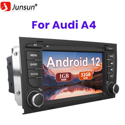

Not too sure if i should ask in here or else where but today I have been head unit shopping and then remembered I have the bose sound system/amplifier so what options do i have? This is my current head unit

Lots of options but price range maybe more of a factor and what do you want from the head unit.
Bluetooth connectivity, maybe a sat nav/google maps and maybe have carista on it so android based something like this
I do have something similar to this but got lost with wiring adapters/harness
If you want to keep an OEM look then you will have to look at the Android based Head Units; like mine...
IMG 0153
Mine was made by a company called Xtrons and has been rock solid for over 6 years; their current equivalent is this - https://xtrons.co.uk/audi-seat-vari...-ram-64gb-rom-global-4g-lte-solution-px74a4al . Otherwise generic or branded 7" HUs, like Pioneer, Alpine etc. are very good and well made; but usually a lot more expensive.
