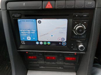

I don't have android auto, I'm still using a fm transmitter on my rnse lol
Nothing wrong with that; always something nice about true OEM. Mine had a Symphony cassette (fer Christ's sake:tearsofjoy:) and 6 CD; there's voice actuated bluetooth phone prep too, with MSFW; I'd of probably not bothered if it had had RNSE. The Xtrons is a RNSE lookalike; I've been lucky with it; great sound great function. It took a bit of software fiddling to get the mic button working for Google Assistant but that was a gamechanger; everything is controllable by voice now, calls/music/nav, without having to touch the screen. Android Auto (and Carplay) is a gamechangers TBH too, for me, from the built in Android app stuff. I only had to add a Motorola MA1 5GHz dongle in the glovebox for the wireless bit.
Model number would be nice as that would be a nice upgrade i might consider if I can find one at a decent price (read probably the Chinese counter version) as I've seen a few but wasn't sure about them. Thing is if tou can provide the model number I'll probably be able to find the exact same model but with a software update.
Reactions: B7Tourer
It's a bit old now, Northpole, 6 years, no longer made. They have a similar unit currently (https://xtrons.co.uk/audi-seat-vari...-ram-64gb-rom-global-4g-lte-solution-px74a4al) which is much newer, faster processing - no DVD/CD, like mine but that's not a problem these days - and with wireless AA and Carplay already built in (I had to use a 3rd party app and dongle). It's at a similar price to what I paid. Xtrons UK is better IMV buying from than Aliexpress, I had good support and service from them.
The model number of mine if you see it available 2nd hand was PB78AA4RP. Even though it's probably not worth buying now, it still is plenty fast enough for me and good enough; 4GB/32GB with extra SD card storage too. They've improved quite a bit now though, in terms of CPU etc. And Android version, mine's 8.0, the linked one is up to 14. You can upgrade mine to at least 10, but I've not found the need.
Thanks but imho afaik they just buy it in from China actually theunits are the exact same from Joying and pumpkin... I don't mind less support if it works properly out of the box though... so I'll have a good search about and see where I'll get it from....
New one looks good though
You can and it's cheaper for sure; but they often don't speak English and support/returns are flaky; which you could end up minding about. Alibaba - the BtoB version, is better to buy from. The hardware/software is generic Chinese; all these brands are just re-sellers, they don't make anything; the fittings and facias are all made by one or two companies too, so there are many similar looking units. The problem often with B7s are the Bose/non Bose setups; a lot of these Chinese units introduce hum and ground issues; I've been very lucky in that I have neither; it was simply plug and play, on my non Bose Audi. A huge amount are not. Xtrons is just another re-seller too but they have a UK presence and support. I'd buy from them again and probably this unit - but that's no guarantee I'd be as lucky as I have been neither, unfortunately. A lot of them are hacked versions of Android too and the version will be a lie - they say 14 when it might only be 10/11 for example - Xtrons tend not to do that, from what I've seen. Although the canbus steeringwheel control is generic hardware on all these units, the implementation is very variable too. The Xtrons was pretty bang on; with just some software digging to get the mic button working.
If you specifically want this RNSE 'lookalike' then the choice is becoming narrow, as our cars are falling off the popular list. This is the 1st one that Xtrons have had for a while again in this style and there is not many on Aliexpress either. If you go more universal then you have the option of a bigger higher rez screen - 9.5" fits quite well - and much higher spec too. No physical buttons there though. 7" is more than adequate for me. I've got DVR, Dab+ and reverse cam attached too. FM and Dab+ are poor, the latter because of the poor stick on screen antenna and the former because of the diversity Audi system; that I've written about elsewhere - this is common to all aftermarket HUs, Chinese or branded European; so if they are important to you be warned. As I say I'm all AA now, including internet radio, so they are not really an issue for me personally.
If you really want to dig into it, before you buy, a good read here - https://xdaforums.com/c/head-units.3833/ - is pretty essential.
