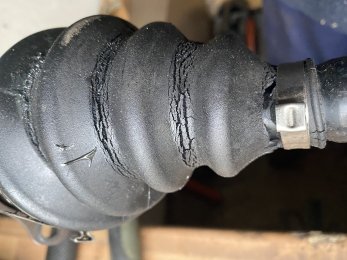

Before that, another check under the bonnet revealed my nearside inner cv boot has torn and the outer has lost its clip, will need to order new parts tomorrow,no obvious signs of what is causing the shaking either, everything feels tight joint-wise, I'll have to dig further into it.
Ran a vcds scan and all clear so that's always a bonus, will need a pair of new tires shortly but I'm holding back to see what SCC comes back to me regarding my claim for pothole damage.

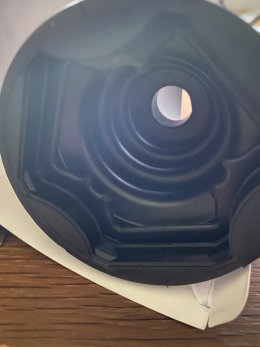

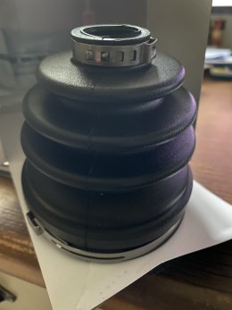

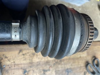

Today I decided to try and get to the bottom of the really irritating shaking and vibration from the front end of the old bus.
The front nearside inner CV boot was split anyway so in need of attention, my local motor factor shop ordered me a Borg&Beck cv bootkit which I must say is very good quality and a perfect fit.
So off with the drive shaft and on closer inspection with the inner boot removed the tripod joint seems ok so with plenty of grease still in the joint so repacked it with new grease, and new boot on.
The outer cv joint was not so good despite the boot being ok and not leaking.
With the boot on there was a lot of movement and certainly worn, but when i removed the boot the inners were rattling around a lot and very little grease was to be seen.
Where the grease went is a mystery as the boot wasnt damaged so an odd one really but the joint is worn to the point it needs replacing.
I suspect this is the source of my issues to be honest, I'd discounted the outer CV to a point as the culprit with the inner to blame.
Just to be 100% , I cleaned it up, repacked it with grease and a new boot, refitted the shaft and a test drive later the symptoms were very minimal, safe to say that the outer is the problem.
Probably best to order a pair of complete shafts now rather than just doing the outers, just need to find some decent quality items at a sensible price.
Decided against J&R as they seem to be very poor-quality complete units with a lot of less-than-idea comments across many brands of cars etc.
So a good day in some ways, at least I've found the point of failure, maybe the pothole incident didn't help the joint as the problem ha sonly really come to a head since that crunch.
time for tea and biscuits now.:yes:
