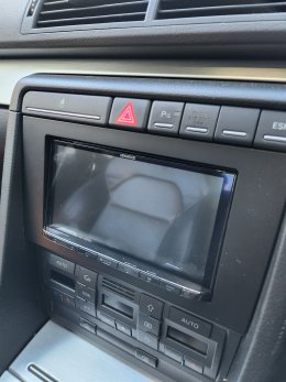

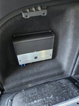

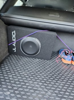

Hi all,
Just got an AV upgrade on the car finished.
-Kenwood DMX8020DABS head unit with DAB aerial
- JL Audio C2-650 FR component speaker set for the front
- JL CP110LG-TW1-2 subwoofer/enclosure
- JL Audio XD500/3v2 amplifier running the fronts and Subwoofer
- JL Audio RLC remote bass level adjuster for amp
No pircutres of the font speakers as they are just behind the OEM grill. Sub is secured as you can see with a bit of bungee.
Front doors and boot have been soundproofed as well.

Hi all,
Can’t beat a good audio upgrade, the OEM setups on these cars are poor even with Bose. I’m running those JL C2 650’s in the back on my system, good speakers. Dynomat’ing the doors is a must when running an active set up, sounds so much better with sound deadening :rock:
Reactions: eel and Charlie Farley
Yeah the soundproofing has made a crazy difference. I am super happy with it.
Next step for me is stage 2.
