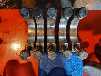

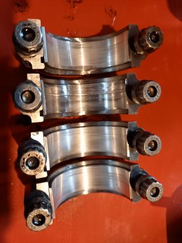

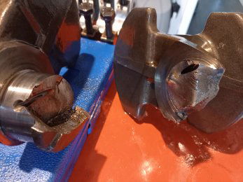

Indeed, Sorry to see that mate.
That's absolutely gutting. Is yours modified?
Not good at all chap, to much boost by some chance or lubrication issues leading to metal fatigue
That's going to be a big hit on the wallet too.
best of luck with it .
Thats not a power related issue iny opinion. That might be related to heat or previous damage. Thats not damage I've ever seen or heard of. Did you have bad rod knock? Was there any other damage? Sorry to see that happen man.

Im in the process of breaking it down, i agree the route cause is from previous undetected damage and its given up finally, if it was stock it might of lasted a bit longer but hpw much who knows. No bad rod knock, just almost like a rattle when the dual masses give up is the way id describe it.
Don't beat yourself up. It was running fine, just making some noise!

Wow you did a good job on them piston's donfero.
Just got the TWO cranks out of the bottom end. Split on the 2nd rod from front, all the shells have about 22k miles on them too
Reactions: tr7
Not with the old bus but i'm having a nightmare with my V8 , really struggling with oversize bearings/pistons & rings and the crank needs a regrind....arghhhh
At least the block is not too bad but need a rebore due to scoring that wont hone out.
