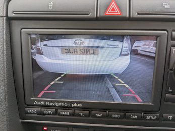

The camera looks fine Rob, mine sticks out a bit but doesn’t really bother me. Resolution on yours looks pretty good too. I remember the fun of taking the tailgate apart to get the cable in, great fun!
