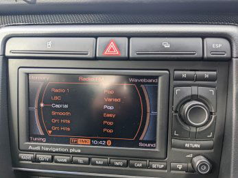

Now on eBay looking for a card and coin holder… Cheers for that lads, didn’t realise I wasn’t happy with the blanks until tonight!
Reactions: Ricky Burrows and Fully

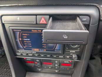

Is it easy to fit, ? Did you just push the airbag light behind.
I just wrapped the light in a cloth to prevent it getting scraped and push it behind, plenty of room
The dash tells you anyway about Airbag status so its no issue
Hi, yes that is what I thought, now the removal video posted above, but if there is not one fitted cant you just remove the blanks and esp and push into the open space?
The blanks just push out and the ESP and airbag need disconnecting then pushed out, then the ESP button goes back in beside the tray
Almost certain you can remove the coin tray etc from above without the radio being removed.
Don't see a reason why the radio needs to come out
Top panel surround of the console/dash and then a flat head straight down to release the. clip and it pulls out
These bits here stop from pulling it out with stereo in place.
It does mention it in the tutorial i linked

Fitted mine today, easy job to do, the hardest part is finding a card box in very good condition
