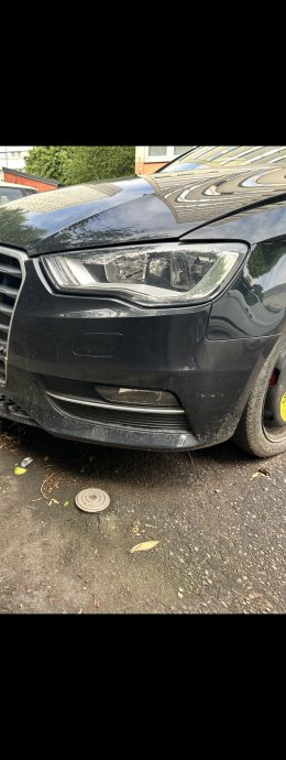

Audi A3 , 3door 2013 bumper
sorry to message on here but I please needed help . I am trying to replace my Audi A3 SE 2013 bumper . 3 door but am not sure which other year bumpers can fit on my vehicle as I cannot find one for 2013. Will a 2017 SE bumper fit . also will it have to come froma 3 door car or a bumper from a 5 door SE car will fit

2017 will be a facelift and your 2013 is a Pfl.
headlights were different in the facelift so unless you swap the headlights as well it won’t fit.
