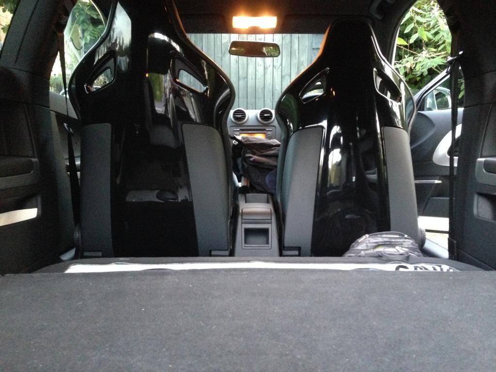

Then yesterday I decided to take the back seats out in preparation for the 'ring trip, going to order a couple of bungee cords to hood luggage in place of the rear seats.
Laid some old carpet down out my clio 182 which just makes it look abit tidier than bare metal and will stop things vibrating, i have left the boot floor in with the jack/warning triangle and first aid kit etc stored underneath.
Exhaust sounds alot louder now can really hear it pop and burble
New airfiter to replace the old deteriorating ITG, fits alot better with it being slightly smaller
No more rubbing on coolant pipes

Those rear seats weigh about 60kgs all up so it's an easy performance gain to take them out.
Every bit counts,and that new brake setup will lose about 20kgs over the Audi iron.
Mine also has the open-plan look.....
I was surprised by just how heavy the stock brakes are,and the seats.....might be leather but feels like the whole cow is in there.

Nice! Yeah the foam base never had much weight to it but the backs aren't half a good chunk! Last year i got stuck with the luggage in the car while going round the trackso it was squatting and rubbing a fair bit, so taking the rear seats out will compensate the extra weight just incase that happens again this time
