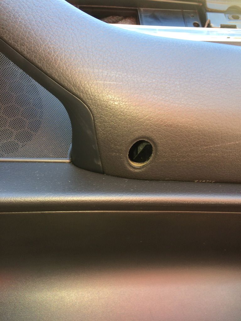

Remove the tweeter grill up next to the door handle using a trim removal tool in the end nearest the car as shown in photo. This is because there is a screw for the panel behind this grill.

Once you've done this all screws to remove the panel are visible.
one behind the tweeter grill.

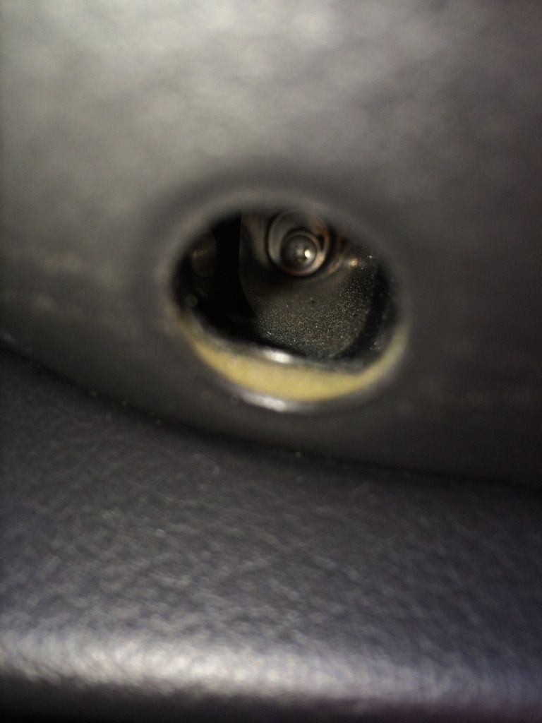

one in a hole on the bottom of the door pull.
http://i284.photobucket.com/albums/ll13/tony22593/IMG_0440_zpsjnj0vfut.jpg~original
http://i284.photobucket.com/albums/ll13/tony22593/IMG_0441_zpskqfmzlxu.jpg~original

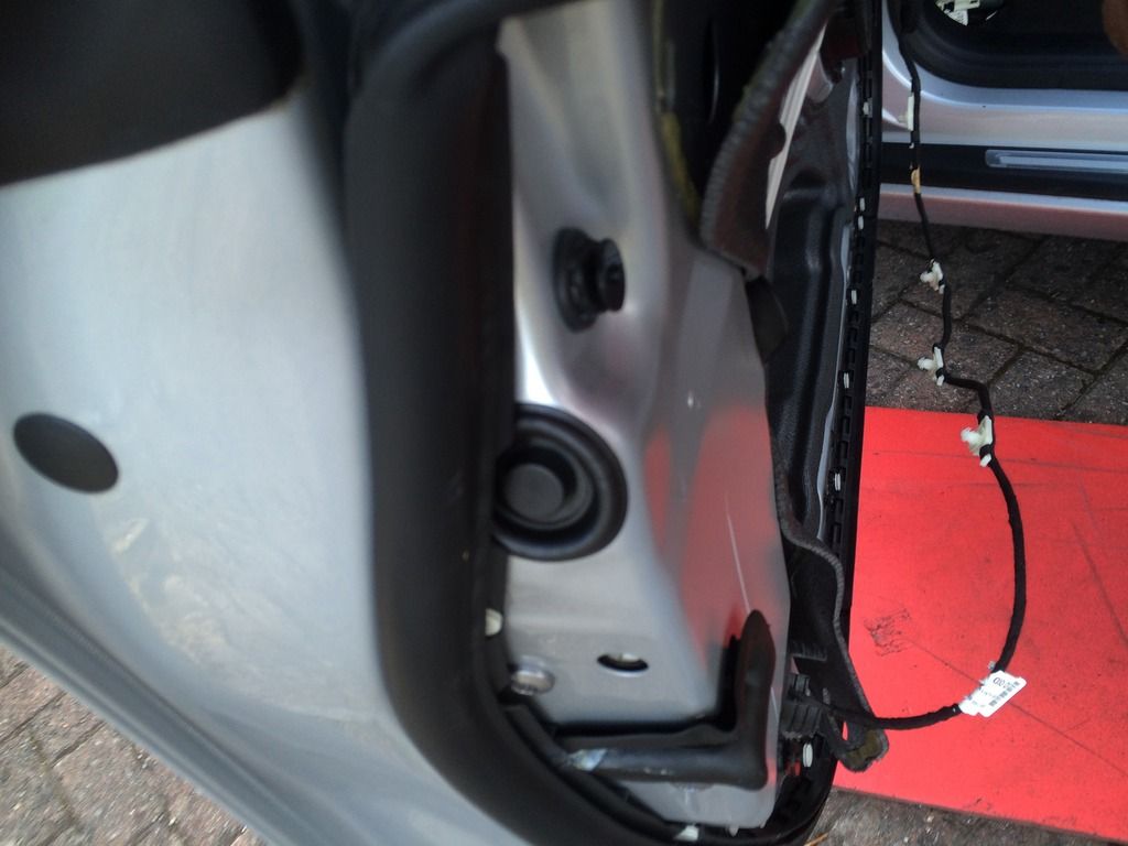

This is a picture that shows the hole in which you have to get the connector and gromet through. (with mirror removed for illustration purposes)
http://i284.photobucket.com/albums/ll13/tony22593/IMG_0482_zpsbdshcwyv.jpg~original
This is a picture with the frame lifted up about 1" 1/2 to 2". But it shows the added clearance in which it gives the connector and grommet to go through.

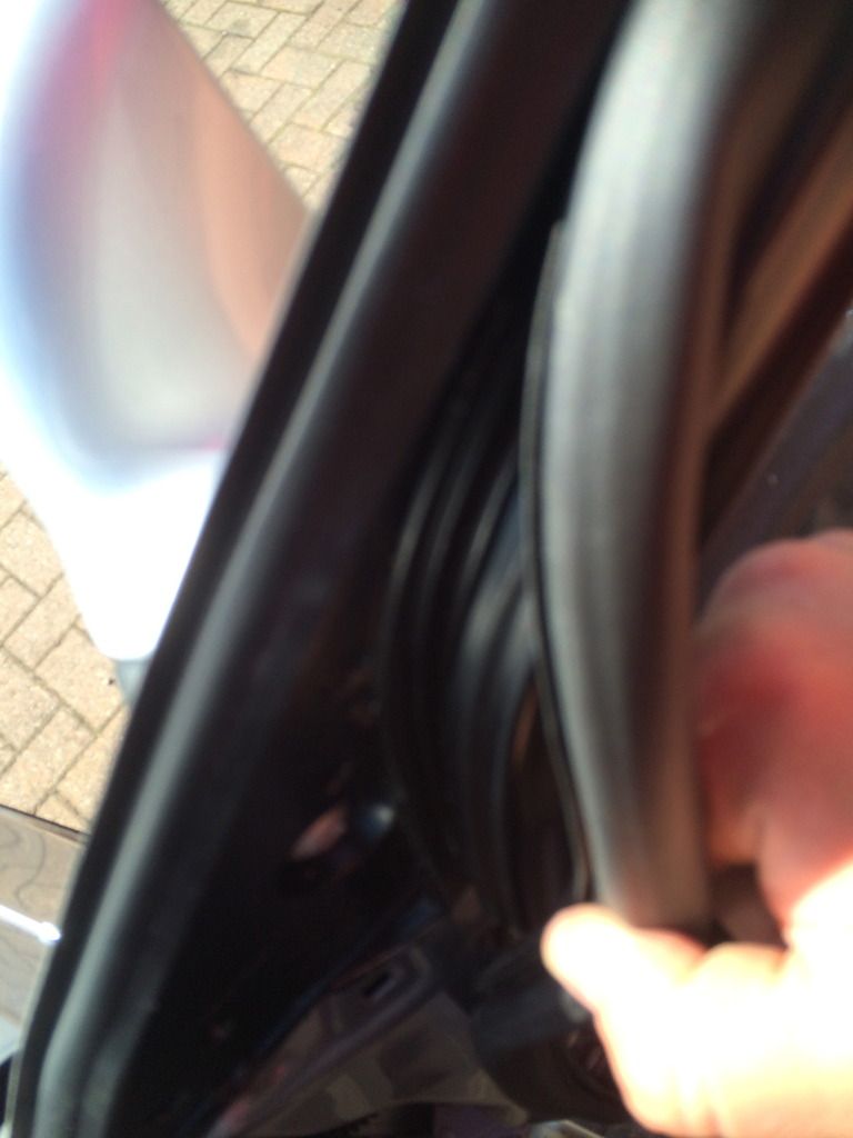

Heres how to lift the frame up.
Firstly un-peel the door seal from across the top of the door and unclip the seal from the top 2 clips on both sides.
http://i284.photobucket.com/albums/ll13/tony22593/IMG_0445_zpss5tyw2sz.jpg~original
http://i284.photobucket.com/albums/ll13/tony22593/IMG_0446_zpswrimqkk3.jpg~original
In this picture it is not shown but covering the part where the mirror bolts to the door there is a small plastic trim. Once you have peeled the seal off the top of the door it pulls of with a bit of gentle force ;).

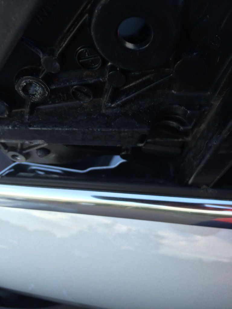

There are 2 T30 Black bolts
one is at the bottom on the latch end of the door and the other is at hinge end underneath the top hinge.
http://i284.photobucket.com/albums/ll13/tony22593/IMG_0474_zpsdhwajwmx.jpg
You can see the first of these bolts removed from the bottom left hand side of the door in this photo.
http://i284.photobucket.com/albums/ll13/tony22593/IMG_0469_zpszze2m4vd.jpg
