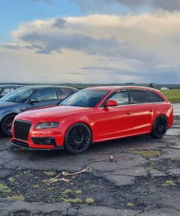

Hi everyone, I have a an Audi A4 B8 3.0 Tdi Avant Sline auto CCWA engine and wondered what you would recommend I do next for more power, I can't afford to spend mega money. I currently have the dpf gutted Egr blanked and both mapped out, a K&N cone filter, Darkside developments turbo hose running around 320 bhp and 700nm not had a gearbox map just engine remap and then egr and dpf mapped out with more power. Thanks for any suggestions
Drop me a mail I got plenty of options available and all parts in stock
You'll need some budget but then next will release a real 330hp / 800nm
