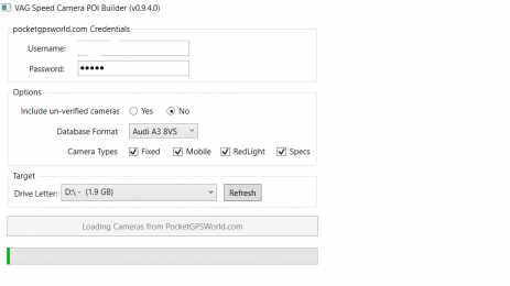

Morning all,
I'm having problems downloading speed cameras using the mcaddy app. The data base starts to load then the app suddenly closes ( I do have an active subscription).
Anyone else having this issue ? , perhaps @mcaddy can throw some light on it.Screenshot 37
The problem seems to have resolved itself, the app is working fine now, :friendly wink::friendly wink:
