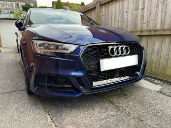

Which grill did you get and how was the fitting?
I fitted one from AliExpress as it was about £100 cheaper than eBay. I had the seller send a chrome and black rings as I wasn’t sure which ones I wanted. I bought a genuine quattro badge from tps though as the one the seller included was abit poor.
Fitting was ok to be fair
Reactions: AlS3BE

What have style did you replace the grille with?
The one with the chrome rings in the pics a couple of posts back. I’m retrofitting acc and had the honeycomb grill with black rings (without acc) and replaced it with a honeycomb grill with silver rings, acc hole and I added a quattro badge
