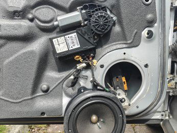

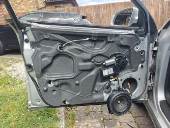

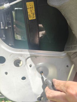

I took the passenger door panel off first, didn't need a blade, just peeled off the foam, got the window up, and next is taking the rest of it off when I get the regulator..... I got a quote of £474 for both doors, but not at that price !!!
I may as well carry on when I have a day spare (it will take me that long).

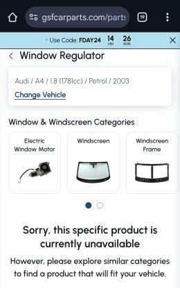

GSF car parts not available:
Euro Car Parts when filtered, even on the basic 2003 year only selected, nothing available
IF I search through Google, parts will come up, but how do I know what's the right ones? They are all £72+.
On AutoDoc, they are £23 to £82.... loads of brands on there.

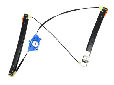

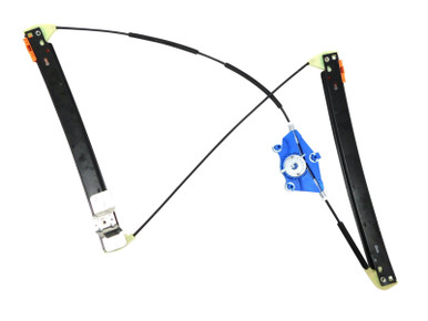

CarWindowRegs has them for £24.90 each:
Passenger:
Drivers:
Which one..... from where pls?

As for what one to buy, they are 'handed' so need the correct one for the side, I have bought ecp ones.. which didn't last long & in the end resorted to the cheapest ones i could find on ebay.. they've been ok for the money.
Some places only sold them complete with the motors which i've never needed.
