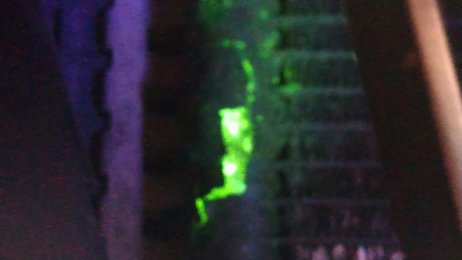

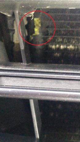

Hi
I complained to Audi UK who contacted the "un named dealer". I took my car to a local dealer who stated its corrosion so no warranty claim. I have only had the car 2 months (used approved Audi) and aircon for 2 weeks working correctly.
Local dealer found hole in Aircon condenser. Garage I bought the car from now replacing condenser and re gassing AC for FREE as a good will warranty claim.
Seems you have to complain a lot until Audi give in.
