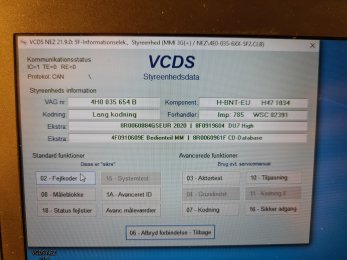

My A6 3.0TDi Avant bit of a rebuild and repair thread.
Been giving some other projects my attention but still need to wrap this one up. I installed the newer gateway and had all CP removed, but nothing changed. Latest auto scan is below.
I assume I've got something wrong in the green menu?

Hey guys, i see a lot of people have problems with the 3GP and i`m one of them. Today we retrofitted a unit from 4G and now nothing except the multimedia is working. All options in Car are greyed out. We try fiddling with the green menu but nothing worked. Im running 20 pin fl can with sw 0035, i know the only newer one is from Q7 with SW 0058, but such file does not exists, Is it sure that if we get such gateway things will start working. I also read that the unit need to run in Q7 mode, what does that mean exactly, Doesnt q7 and a6 share the same software. Here is the car log:
So I'm learning a few things the hard way. Turns out my original gateway had the 0035 software. I installed a Q7 gateway (0058 software) hoping to fix the exact problems listed above. No luck with either gateway. Still missing steering wheel controls and MMI info on cluster, Car menu is greyed out and clocks aren't correct.
I really believe it's a simple VCDS or green menu option. I have tried every combination I've found on the forums so far but no success.
we made a progress today. you need to download software for a4/a5 and then a lot of things start working. software for a6/a7/a8 is different. it also works with 0035 gateway

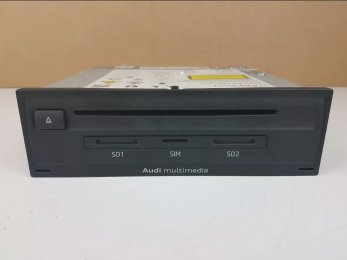

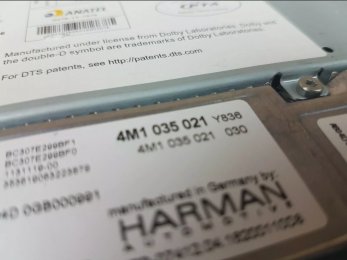

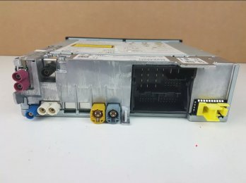

I have another question maybe you can answer. When upgrading to 3G+ you should use the control panel from a Q7 as there are some changes in the buttons.
Are the radios compatible in our cars? I found a radio (with Dab+, because we don't have FM in Norway any longer) with number 4M1035021
This have a sim slot, which means it's a 3G+ If I understand correctly?
Maybe I should take the leap and go straight for 3G+ instead of 3G.
The only thing that needs changing when upgrading from 3G to 3G+ are the main unit and nothing more?

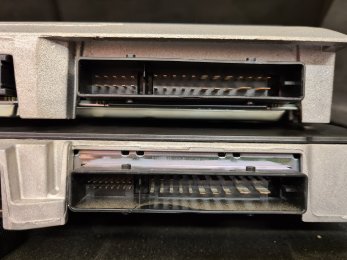

I have repinned the gateway and converted the infotainment cables to the quad lock, but nothing works.
The screen remains black..

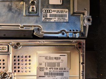

I also ran into another problem with the Bose amp I bought from a C7:
The pins are different. I tried to do a quick search in the difference between them, but I didn't get any wiser.
Did you have the same issue too?

Yes the pinout is different between the Bose AMP's, so you would need to fit a new plug. I got all the pinouts from elsawin or you can download them from Audi's erwin web site. If the screen is black then you have a wiring issue. Can you communicate to the 5F unit with your diagnostic software?

I finally got the CP removed, but as my unit came from A8 I need to change the sw to Q7.
But I can't open the green menu.
My setup button doesn't work. How can I access the green menu then? Is there any other option?
All the other buttons seems to do like they say except "name" which is "menu."
Ok, so another issue. Maybe not the right place for it, but since there are several people here that have done it, it's worth a try.
I read the whole thread before I started, and read initially that the 3gp from A8 are no good in our A6. Then later in the thread some models are "convertable".
In good faith I bought one from a 2014 A8.
The side of the unit say 4H0 035 670 P
But vcdc say 4H0 035 654 H
I don't know what is the right number, but to the point.
This is apparently a MU9411 and as I understand I should have MU9498
Is this doable?
What do I have to do? Can I download the correct software and force install it through green menu, or will this brick the unit?
I downloaded and tried the newest software for Q7 with standard install and as expected denied permission due to different MU versions.
