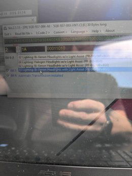

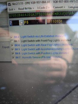

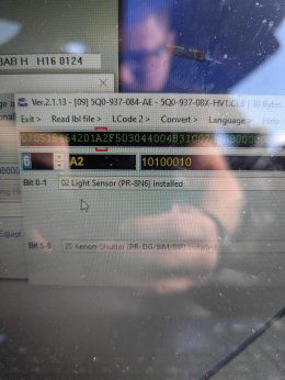

Good evening guys I will be fitting new humidity sensor “b” version and auto light switch this week , can any one point me in the right directing for changing the coding with vcds I found a guide buts it’s not vcds coding
cheers brad
cheers brad
I’ll reply to my own post as iv done the retro fit today working auto lights and wipers for anyone I’ll attach my vcds points that’s I changed for my car
hope this helps someone else down the line
