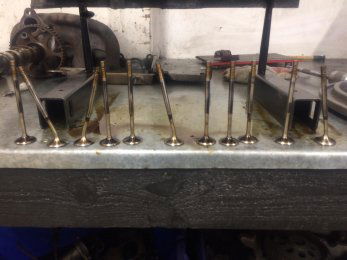

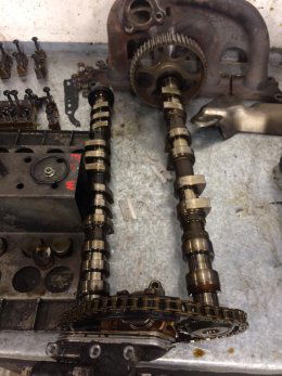

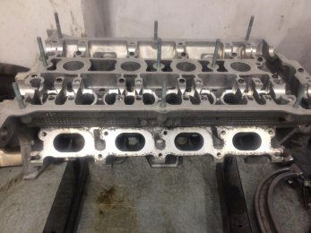

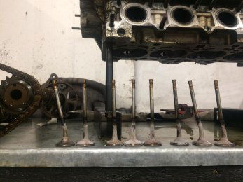

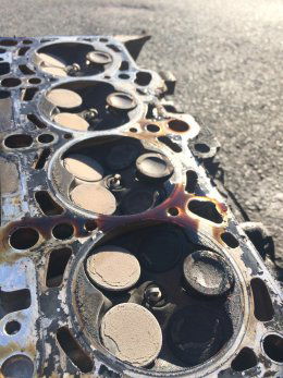

Well. Engine died. Had new cambelt and waterpump fitted at 191k and the waterpump failed at 220k. Resulted in 14bent valves. Pistons are all good luckily. So the car is off the road getting the head rebuilt so hopefully have it back and working in a week or so. Finally sorted the abs issue out which turned out to be a faulty abs module. So fix one thing and other thing breaks

Well the head has been removed and cleaned. So 14 out of the 20 valves were bent so all 20 are getting replaced. I should have it back by the end of the week hopefully

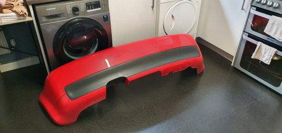

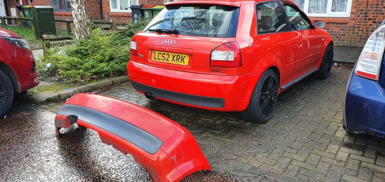

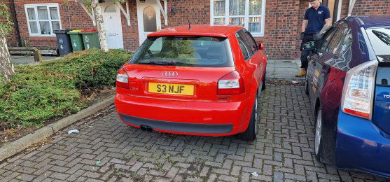

Well. Just recieved my newest purchase. Its only taken me 3/4years to find someone breaking a red s3 for the rear bumper. Other half reversed into a bollard back then. And hopefully have it back working tonight aswell as its getting a new aux belt and power steering pump
Reactions: Ian W
All cleaned up and fitted now :) shame the rest of the car is filthy with it not moving for 5weeks.

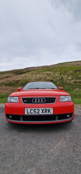

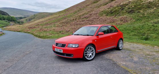

Not much has happend with the s3 recently. Fitted the newer wheels a few months back. Gave half of it a machine polish yesturday as the backing plate on my polisher fell apart. So took it out for some pics today. Still has its issues but they will get sorted as and when i can afford it. Its just tipped over 222.600miles now too

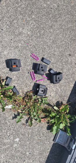

I think ive fixed this misfire. Found the coilpack plug was broke on the inside and was wobbling for cylinder 1. Just changed the plugs and all were brittle and fell apart. Just been for a 10mins drive and everything seems ok. Will go for abit of a drive later and see if it is fully gone but all seems good so far.

@alps26
Awesome! Doesn't sound like it was too expensive either
Nope was just under £15 for the connectors and the key to de pin them.
Just been for a spirited drive and it seems spot on now. Just a few hicups but think that was me.
