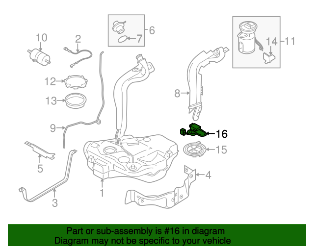

I've been looking some more online to do with the fuel pump control module (1K0 906 093 H) and found a good link for owners of 2L TFSI engines: http://shopdap.com/common-problems-to-look-out-for-on-the-vw-and-audi-2-0t-fsi-engine/.
One of the problems mentioned is to do with the the fuel pump control module, which is affected more by heat: http://shopdap.com/2-0t-fsi-vw-and-audi-fuel-pump-control-module/. My issue is intermittent but so was _G_'s on the thread kash linked of which this fixed it for him, so I will definitely investigate this further.
Money is tight at the moment, but I will get Storm to look at the fuel pump control module and fuel filter for now as I cannot afford for them to have a full day trying to the diagnose the issue just yet.
_G_ mentions the in-tank fuel pump control unit, however the fuel pump control module I've been looking at isn't in the tank, am I looking at the right part where he's used incorrect terminology or is he on about a different part altogether?

Ignore the part about me asking if I'm on about the right part, the fuel pump control module connects to the in-tank fuel pump, it's not inside it! I read a bit too much into _G_'s comment haha.
HHS3
Phantom Black S3 - R-Tech Stage 2+
Right so I had a look at the fuel pump control module myself last night of which there appears to be no melting or other visible damage, however in _G_'s case there was no visible damage either but it was still sending the incorrect voltage. I checked the version of mine of which it ended in a C, I can't remember the whole number but it was definitely the right part I was looking at, however I can't seem to find it online. Mines a 2007 prefacelift S3 and there has been at least four revisions since then which obviously means that my module is prone to failure, making it plausible that it could still potentially be the cause of my problem.
As it is an older version, I'm tempted to just buy the latest revision 1K0 906 093 H anyway and get Storm to fit that along with a new fuel filter for now. A proper session of diagnoses and datalogging will come when I can afford to do so providing the above doesn't fix it of course.

I dropped my S3 off at Storm last week for them to investigate the ECU and FPCM as well as fit two Michelin PS4 tyres and rear spacers. They removed the ECU and gave all the connectors a good clean, they said take it away for now but they're convinced that it is the FPCM.

It's been two weeks now since I've had the Fuel Pump Control Module replaced and there hasn't been a single slow start-up since, hot or cold! I have driven it countless times, both short and long journeys as well as several very spirited drives with no problems whatsoever. There's also been a couple of days where it was really sunny with high temps of which there wasn't any issues here either. I'll report back in a couple of months to see how I've been getting on, but given how frequent I was getting the problem towards the end, all is looking very positive!
I want to say a massive thank you to @kash_v for bringing the thread with the FPCM information to my attention, it seems like I searched for everything under the sun on the forum except for 'hard' start haha. Another big thanks goes to @_G_ for sharing his experience and knowledge with the FPCM, both you guys saved me time and money as I could tell Storm Developments what to look at without the need for them to do a logging session/further diagnostics.
Moral of the story is to just always take your car to a reputable garage, particularly one that specialises in your vehicle/engine/brand, especially if you've got a problem that isn't well recognised nor has an easy/cheap fix. Some of the parts I got replaced weren't a complete waste of money as they would've needed replacing eventually, but I have wasted a fair few hundred quid chucking money on parts like starter motor, sensors and labour by trying to fix it myself using guesswork.

what about the injectors and the rail? Did you checked them? for logging with torque pro app, just google it , there is forum of that app saying how to do it.
HHS3
It could well be either of those as it definitely seems to be a fueling issue of which most of the system has been replaced now. The main parts left are the injectors, rail, fuel lines and high pressure fuel pump so hopefully the Torque Pro app is capable of logging all of those, not sure how it would suggest there's a problem with the fuel lines though..
Perfect thanks I will have a look at how to do that then. Fingers crossed I'll be able to find an anomaly soon as this has been a problem for over two years now, annoyingly the weather has cooled down and I've just filled up with petrol which will delay things.
