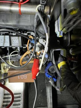

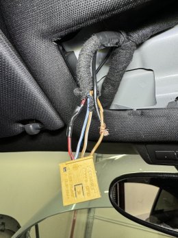

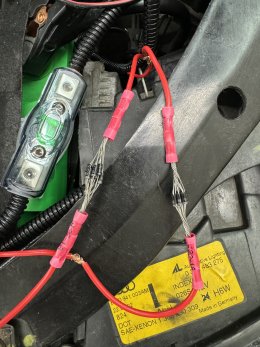

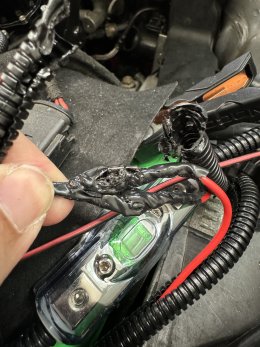

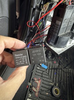

I wanted the welcome home mod. I tried this modification for my mk1 TT. I tried it with one relay first and the diode to avoid feedback kept overheating. Then I tried the two relays, 5 pin and 4 pin. I have the same problem you mentioned where the relay is staying on causing the DRLs to stay on. I used 1amp diodes and ran them parallel to 10amps for each.
They still overheat from the 4 pin relay 87 out. Scratching my head. Any suggestions
