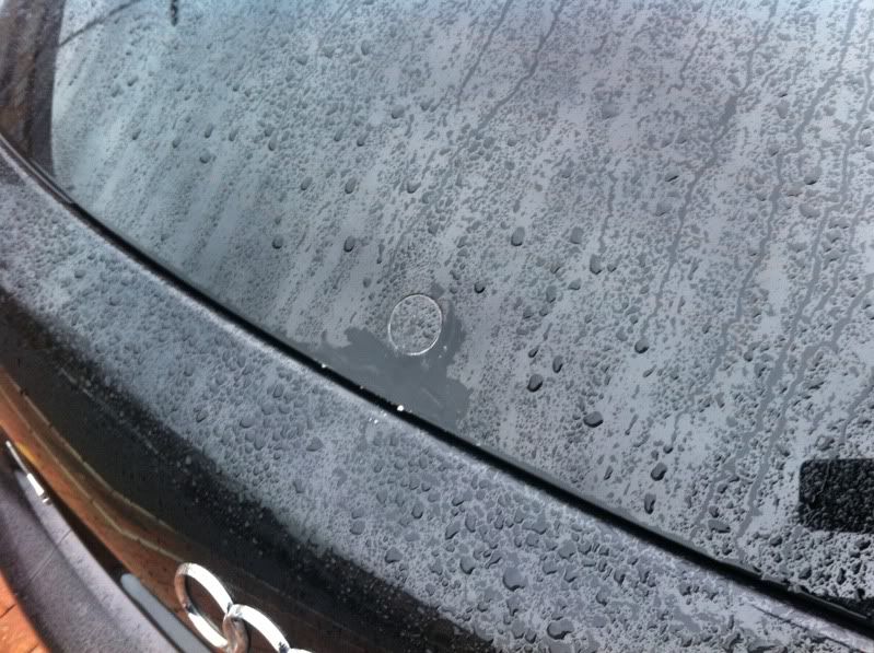

Here a picture of mine, I only did it yesterday, took about 30 minutes taking it steady.
not much to see really lol.

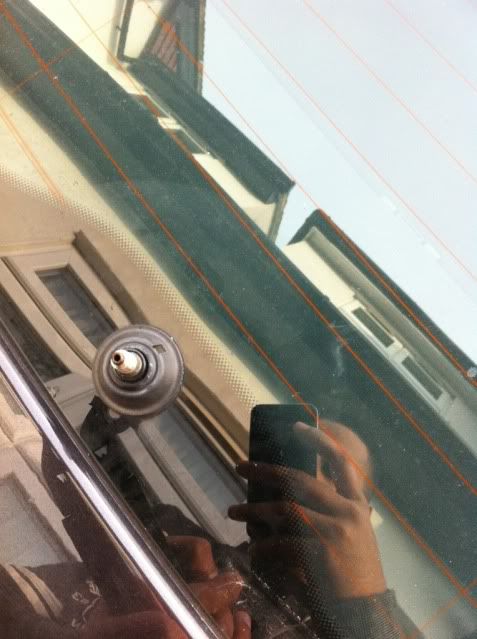

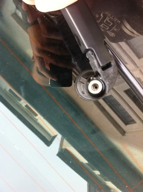

First unclip the plastic cover on the wiper arm, Basically the edges can be spread out so it unclips off
Undo the jet, this simply just needs to be pushed up to fully reveal the nut holding the wiper arm
Once the nut is revealed use a 13mm socket to undo the nut
The next part may be tricky for some of you guys, My car it was easy as its still pretty new so nothing was seized, However spray a bit of WD40 where the bolt was if yours is seized.
Now do not hold the wiper arm but instead try and grip the area where the nut was attached, Try and wiggle the arm side to side a bit whilst pulling up. The wiper should pop off completely

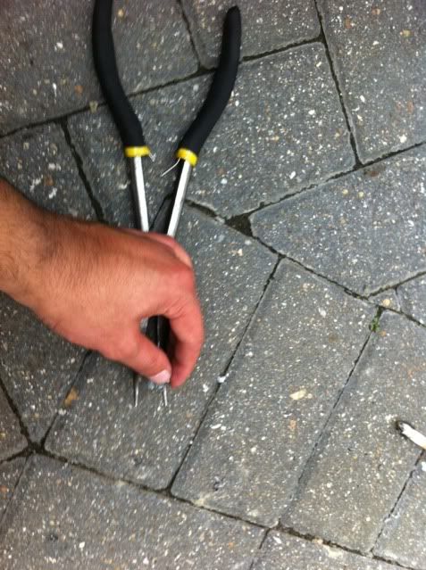

Now i had a bit of a problem as some of the prongs were stuck in the body work to remove them use a needle nose plier as shown below and place it in the prongs and pull down they should pop out of the body work

It looks ok tbh, The grommet is a nice fit but my one is acrylic and not glass. So it is shiny like the glass one but it does protrude up a tiny bit.
Ideally going to let the thing fully dry over the course of a few days then i will revisit cleaning the grommet and the windscreen around it.
For now i have a circular mark around the grommet from the old rubber, any idea on how to remove this?
I tried tardis, clay and glass cleaner it didnt budge :(

Try a rubbing compound/polish to remove the mark around the bung. I had to do this when removing mine
Thanks Moag for your tips had me pretty much set up to give this a go, i thought i would take pics just so its a bit easier for others.
Ill grab the menzerna out in a few days to get rid of the marks once the wiper blank fully seals up.

Cheers dude, give it a go if you need a hand let me know. Got home and used a bit of menzerna on the window and its got rid of the circular mark left from the old grommet so happy days looks alot better now.
