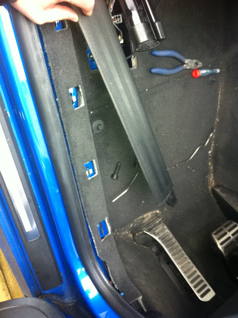

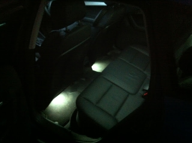

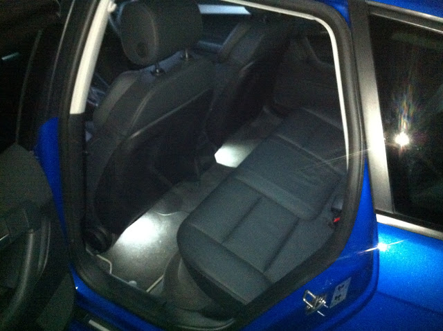

Hi guys,
Just got round to fitting these to my S3 SB after getting the great looms from Robin. I already had his front lights (OEM LED ones) so I wanted to do the same for the rear. This is how I did it…
The drivers and passenger side are exactly the same apart from dropping the glovebox vs dropping the driver side knee knee panel.
First start by dropping the glovebox/knee panel:
and then pull of the side trim next to the door/footwell, it just pulls off outwards and upwards:
Then pull off the side trim, just pulls off upwards. I only went as far back as the B-piller, that gave me enough room:
Also remove the little access panel under the front edge of the seat:
So you can run the cable under the carpet from the door sill to the access panel, you need to tilt the seat back by unscrewing the 4 bolts (one on each corner). You don't need to take the seat out of the car, just unscrew the bolts and push back:
You now need to run the rear footwell loom from the front footwell light, down the side panel, and along the sill:
When the loom gets level with the access hatch/front seat mounting. Push the loom under the carpet and through to the access hatch:
Pull through the loom and then refit the panel:
Sorry no more pics, battery ran out!
Then thred the loom towards the back of the seats, making sure the wire is out of the way and you have enough to allow the seat to move back and forth. Install the light and:
One last pic, here you can see the difference between the OEM LED and the one as supplied by t8ups, as you can see much brighter! (OEM Right, t8ups Left):
Any questions let me know!
