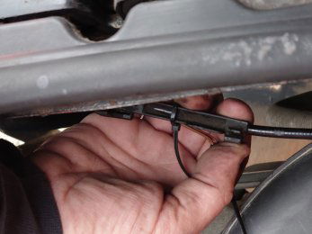

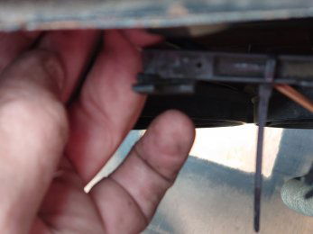

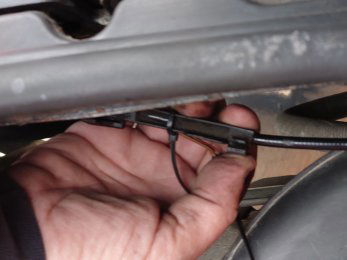

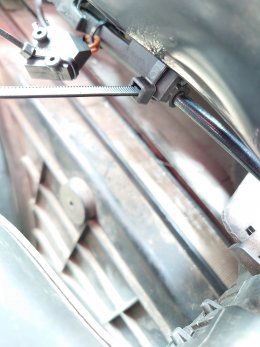

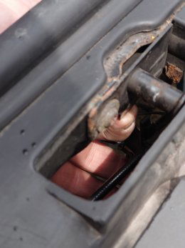

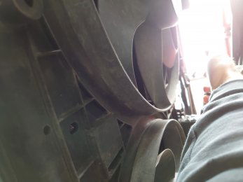

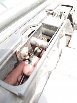

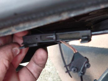

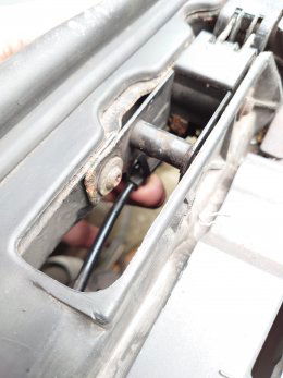

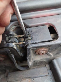

had this problem on mine today , so went about trying to get in and did it with not much hassle
My guess is that this is a real commen fault with these cars
What's probably happened is the cable has just come away from the bracket it sits on so it just can't release it properly
The cable probably isn't stretched and probably nothing needs replacing so deffo worth a check at this first to save u a few quid and time and hassle from a local garage or before you start damaging your car .....
Get yourself a set of ramps , look up to where the cable is situated and try and grab hold of it with your hand
, give it a good pull it should release your bonnet , you don't need to stretch it but a good yank should open your bonnet without stretching the cable ......

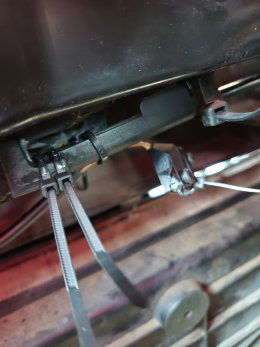

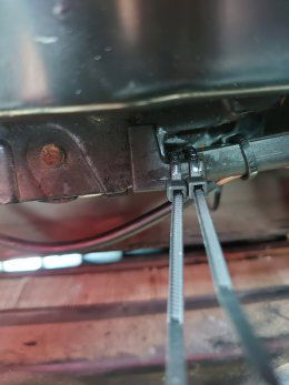

To fix it ,
Get three cable ties
1 Medium size
2 small size ones
Open your bonnet now you have it released

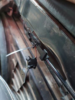

Look over the top of the catch and you will see a plastic cover attached to the cable
This needs re sitting on its two main brackets!!
and cable tied to hold it in place again once there
The rear needs two small cable ties
The one nearer the catch , also needs a cable tie
but !
slid through the small slot on it before pushing it back up into place again !!
It should now work for you and stay in place giving you access again ...

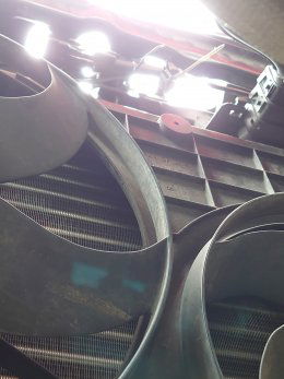

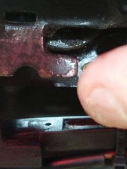

Pics of how I did mine are shown as a guide for anyone having this same problem, the catch is a small release part on the back side of the hinge as shown in the pic
My car is a 1.6 fsi s-line , but you should be able to reach this cable from the under side of your car on any size engine once you navigate past the pipes air con etc
The 1.6 has a good amount of clearance but I can't see you not being able to see the cable through gaps in the bay
Hope this helps anyone with similar problems ...
