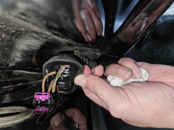

Zombie thread, but had this problem for way too long, and just wanted to add in that this was where my issues lied. After having already replaced literally everything but the door and finding the issue to persist, I circled back to inspecting the wiring. Sure enough, once I inspected the wiring leading into the door, there was the source of the problem.View attachment 258257
Note the completely severed red wire (chance it was barely hanging on before I pulled this apart), the brown wire was damaged, and a few others had slight damage. Reconnected everything again, and it's all sorted. Nice to be able to open the window again. Before this repair, everything was working from the drivers door except the drivers window. When hitting the button, I would hear a click, from the motor, but the window wouldn't move. Replaced the switch, the motor, then the window regulator along the way, but nothing changed - was the wiring the whole time, which I had foolishly ruled out early since everything else worked and I at least heard a click from the motor when attempting to engage it.

Hi just seen this you’re going to have to look roughly in the middle of that rubber boot where the bend point is. The part of the wiring in the picture doesn’t move so won’t flex and break.
I managed to get the rubber grommet/boot off. At least 3 wires are broken. Not sure if I might have broke one wire further as the key fob is not locking my door afterwards now. I can manually lock the door though.
Does this mean I need a wiring loom or repair kit? Anybody know the part numbers for a replacement or have a link to a repair kit? The broken wires that I could see were the brown one, red and green one, black one, and then a couple of others had little breaks in them.
I called Audi to ask for the drivers side door loom, they said that there's two options it could be after first saying that they didn't make them anymore, this was after he said he will check if there were repair wires, so maybe he was talking about the repair wires. The chap wouldn't give out the part numbers for the 2 options that he mentioned.
First option. £197. Connects to the window regulator, switches and mirror. (he said attaches to the door card)
Second option. £197. Attaches to window motor and goes to the car body (mentioned that it has a rubber grommet, that I mentioned when trying to describe where it was, what it looked like)
