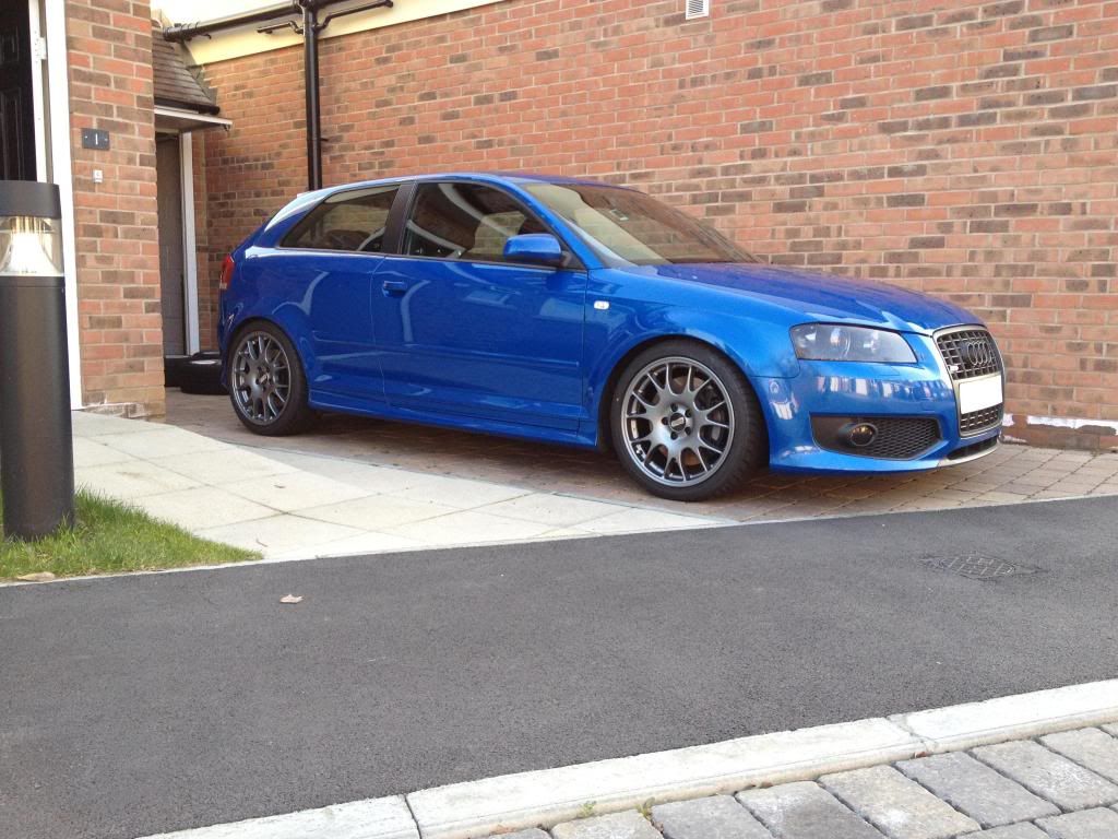

    This is what's on mine....
    kW Clubsports with adjustable topmounts.
    [​IMG]
    And it looks like this.....
    [​IMG]
    [​IMG]
    But it's about as far as you'd want for a road friendly car,as you need some compromise between handling,and a degree of comfort.
