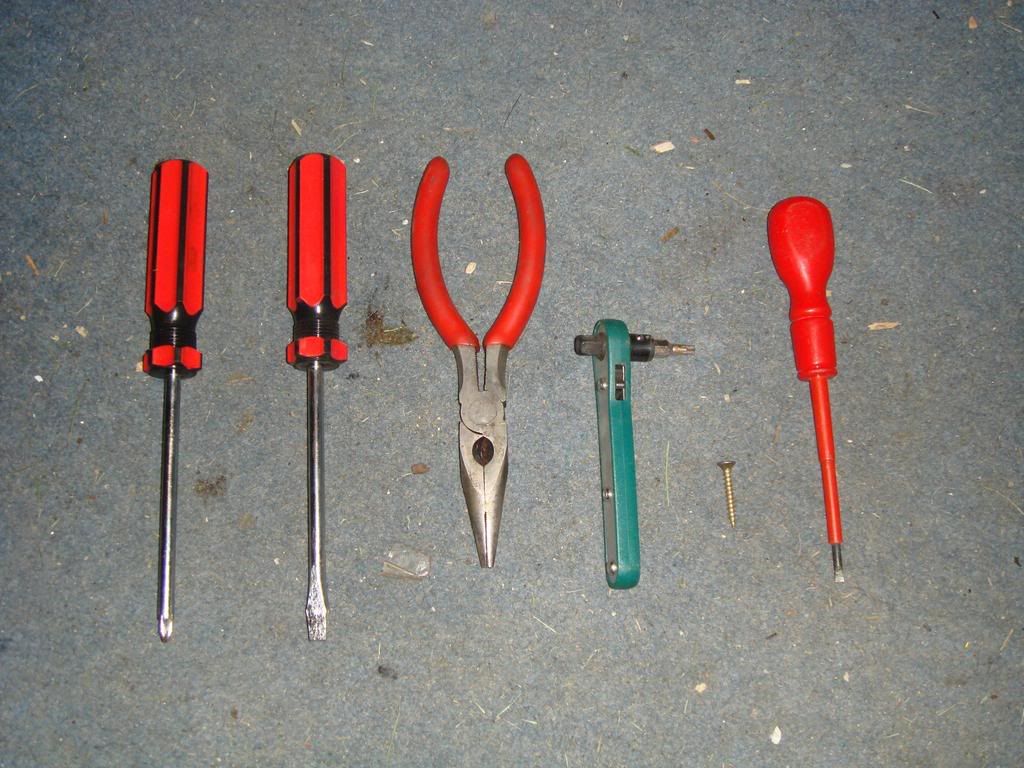

    1. Tools Used
    Proskit 'T' Bar Screw Driver (Cheers HTC for the heads up on this baby) with T20 Torx Bit
    Philips Screwdriver
    Medium Flathead Screwdriver
    Small Flathead Screwdriver
    Small Nose Pliers
    Small Screw
    Box to support the bumper
    Rug to rest the bumper on
    [​IMG]

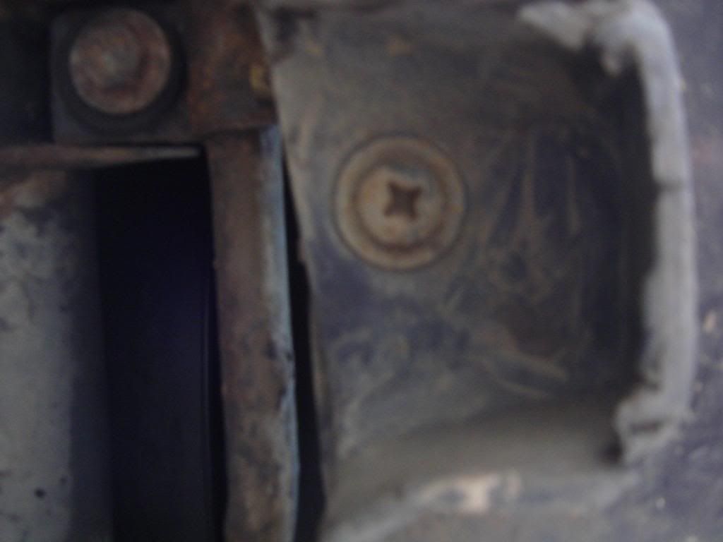

    3. Next remove the two philips screws from underneath the bumper in the square recesses (I've highlighted one, there is another on the other side)
    [​IMG]

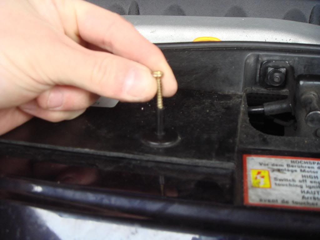

    4. On top of the bumper are 4 x Black Plastic Round tabs; these are both lug and fixing. Stage 1 is removing the lug. The lugs are hollow with a small hole at the top the best way is inserting a small screw. This way you can screw into the lug and then pull it out - easy!

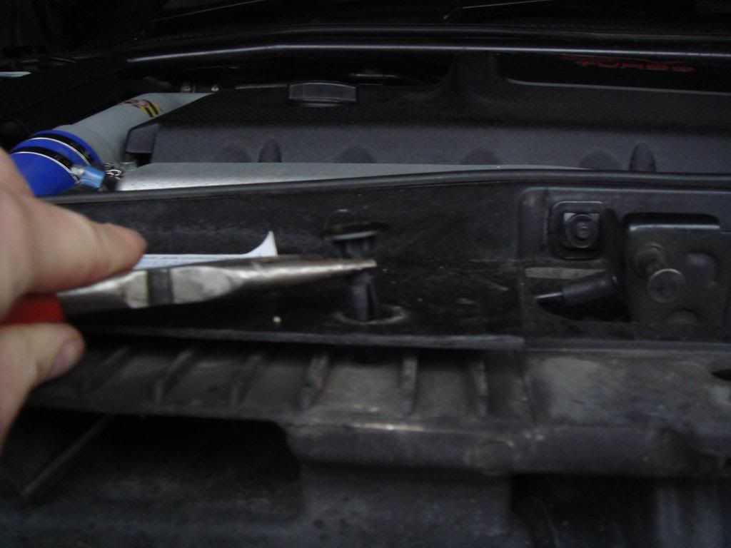

    5. Stage 2 is then taking out the fixing part. Prise it up slighty using the flathead screwdriver and then use the pliers to pull it out.
    [​IMG]

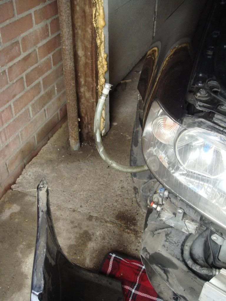

    6. The bumper is now ready to be removed. It is very bendy so don't worry about cracking it (just don't wrench it off woth no remorse). Start at the ends and pull it away to the side and then pull forward.
    [​IMG]
    7. Once the bumper has come away you have 3 connections to undo. 2 are for the foglights (on both sides) and 1 is for the headlight washer fluid on the drivers side.
    Carefully not to drop the bumper on the floor as you may pull the connections out - rest it on a box or bucket to support it.

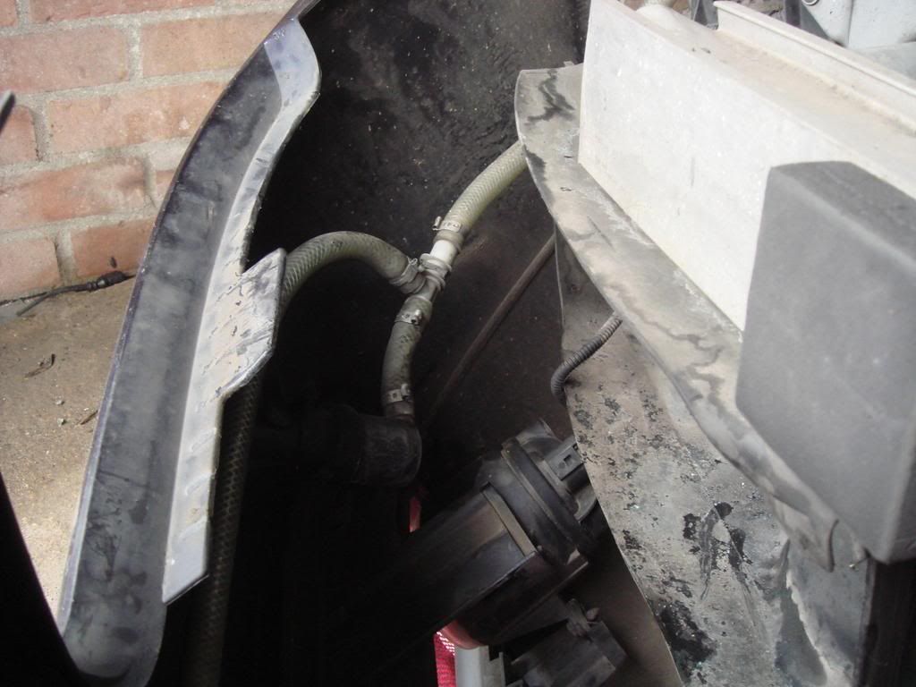

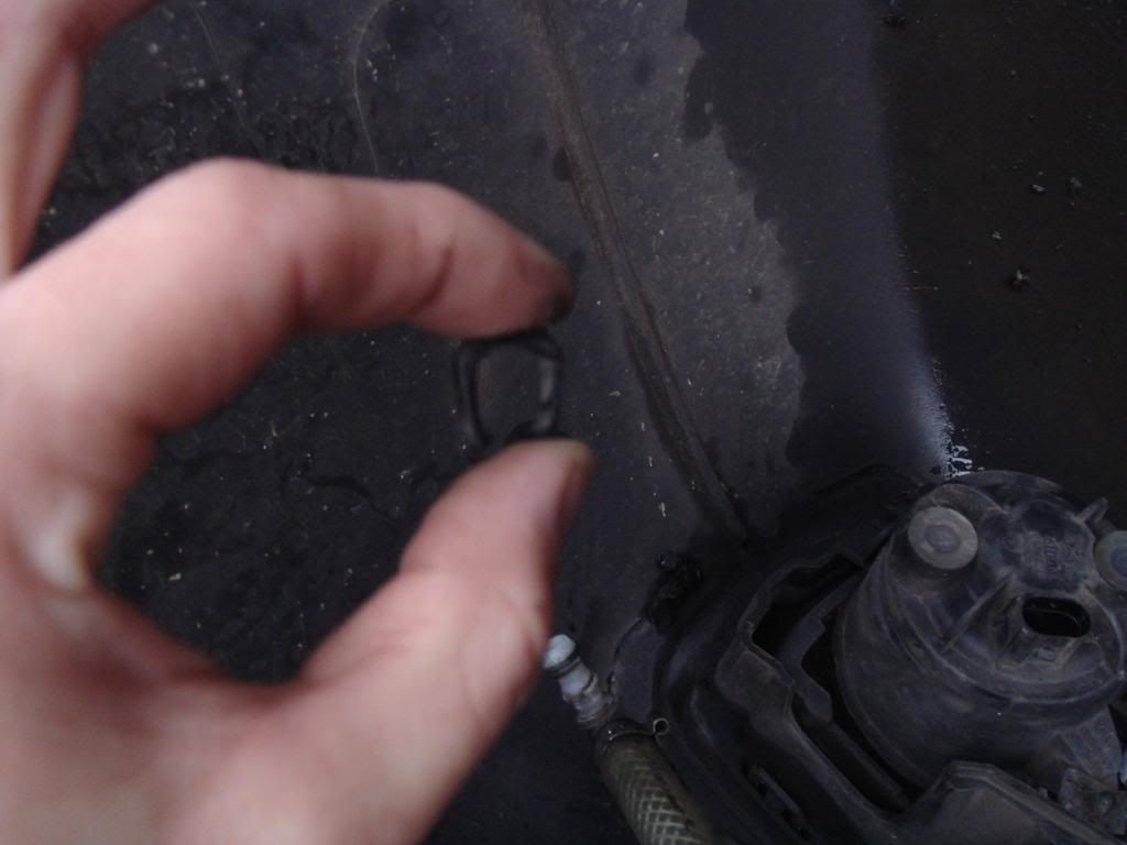

    8. To disconnect the washer fluid there is a small 'U' shaped black clip that you just need to pull up to free the connecting pipes - bear in mind that washer fluid comes out quick so raise the hose above the car to minimise loss and to stop covering you in fluid.
    [​IMG]
    [​IMG]
    [​IMG]

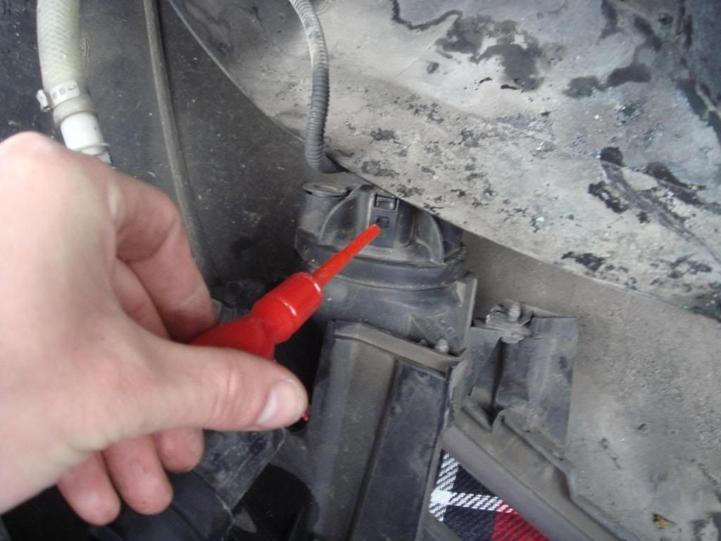

    9. Excellent, now using the small screwdriver undo the clip on both the fog lights.
    [​IMG]

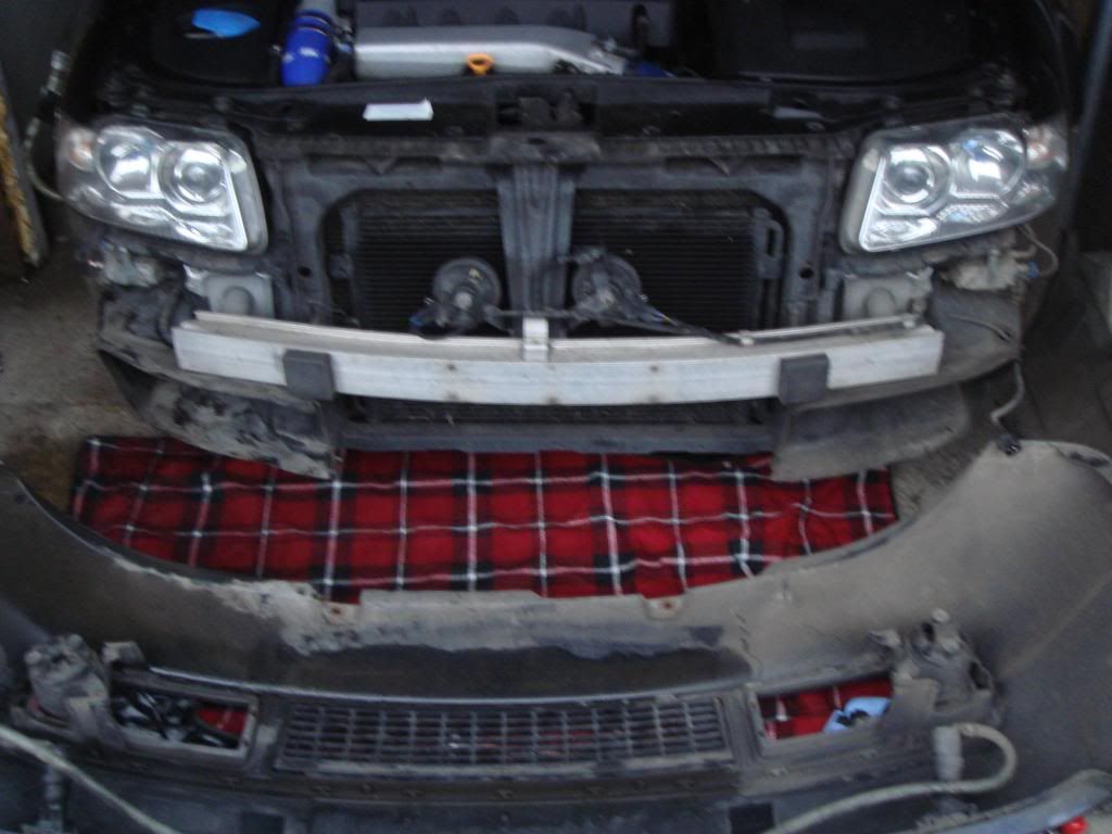

    10. Nice work! All done. Rest the bumper on the rug and crack on with what you have to do. In my case it was to remove the drivers headlight to sort my hose and to fix my lower grille.

    Nice little guide there matey :thumbsup:. I did this last weekend and could have done with a photo guide like this. I especially like the idea with the screw in the lugs. I pushed them through from the top myself, and found it a pain in the arse to locate a couple of them when they fell out into the engine bay!

    I noticed that when you removed the foglight plugs you put the screwdriver into the lower hole of the two. The way those plugs work is you put a slightly larger screwdriver into the hole above and give it a twist. The plug will click and can then be slid it off. :icon_thumright:

    For the fogs I thought they were a push through the hole as it seemed to work well; i'll try the top next time cheers.
