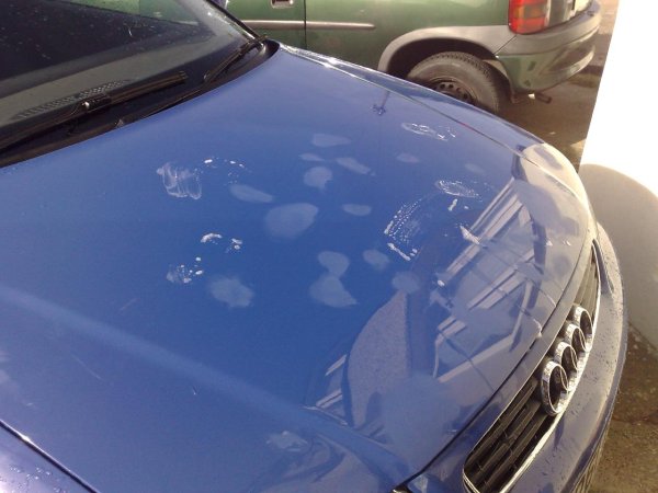

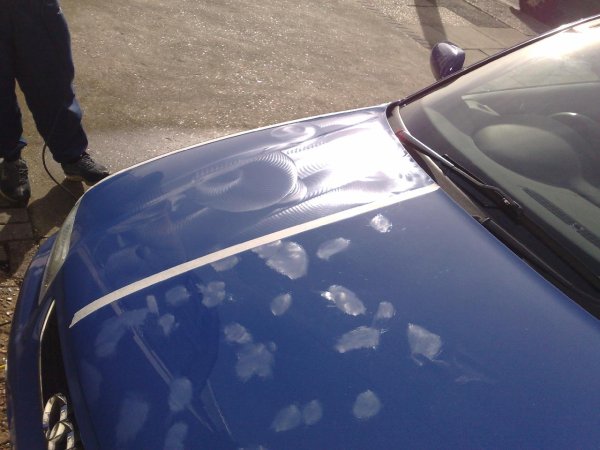

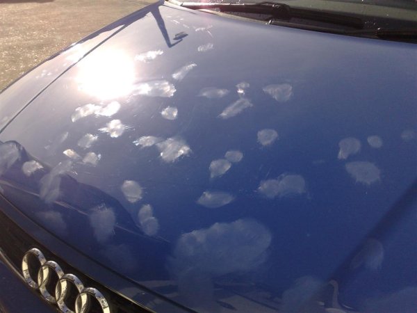

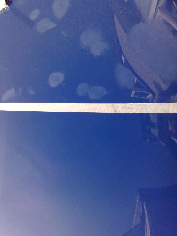

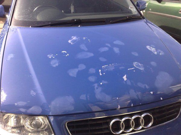

    had a lot of stone chips on the car, got some touch-up paint, a fine brush and filled them yesterday.
    Then this morning used some 2500 wet and dry sandpaper to flatten the paint where it has been touched
    pics after flattening:
    [​IMG]
    [​IMG]
    [​IMG]

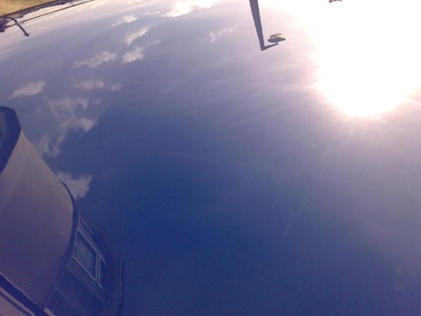

    Then got the UDM out with some Menzerna R3.02:
    [​IMG]
    [​IMG]
    [​IMG]

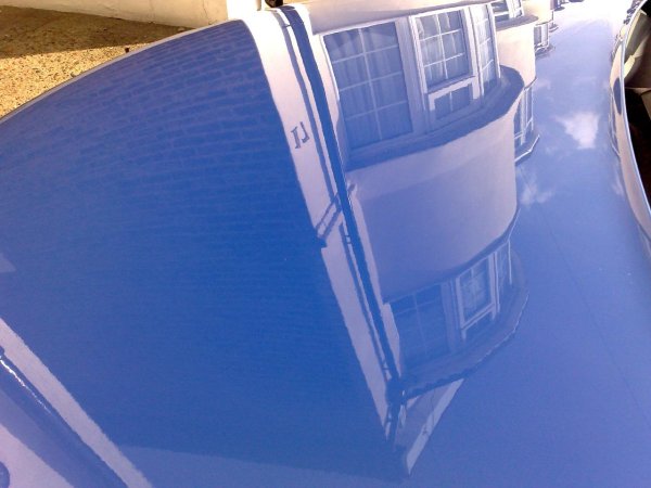

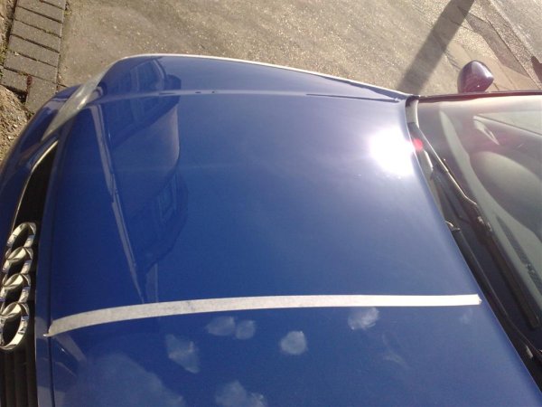

    then use Sonus 2nd nad 3rd stage polish
    and collinite 476s
    bonnet done:

    what I used:
    touch-up paint that already had lacquer.
    use a very fine brush and make sure you fill the chips, not around them.
    allow to dry for 24hrs, then rub down with 2500 wet and dry with plenty of fairy. don't use too much pressure though, just take your time to flatten it
    wash area well and dry
    then I used Ultimate Detailing Machine with Menzerna R3.02 (very easy to use)
    the sonus final finish
    and wax it with collinite 476s
