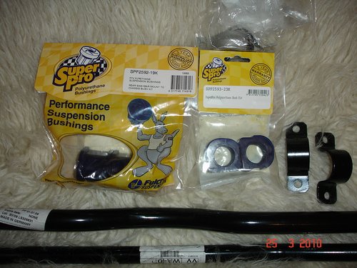

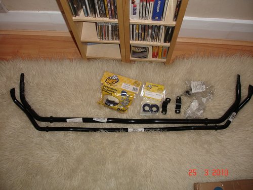

    Their R32 anti roll bars 23/19 with superpro bushes + clamps & bolts
    [​IMG]
    £189 delivered from stoke audi
    [​IMG]
    £35 delivered super pro bushes from Halo performance
    Next step is getting them fitted, the rear seems pretty straight forward will do this at the weekend. The front i m gonna leave to my Audi techie friend

    FRONT:
    1 x 1j0 411 305 AF (FRONT 23MM ARB) £67.58
    2 x 1J0 411 314 T (21MM FRONT RUBBER MOUNT) £4.93 EACH
    2 x 1J0 411 336D (CLIP) £5.50 EACH
    2 x N 101 016 03 (BOLT) £0.80 EACH
    REAR:
    1 x 1J0 511 409 K (REAR 19MM ARB) £89.17
    2 x 8A0 511 439 (ARB CLIP) £4.73 EACH
    2 x 4B0 511 327 Rear ARB Bush £3.27 EACH
    2 x N 010 236 6 (BOLT) £0.62 EACH
    from stoke audi. I went superpro though. speak to Dave in the stoke audi section of AS.

    Well guys i fitted the rear anti roll bar today pretty straight forward, unbolt the backbox hangers (4 bolts) & unhook the centre section rubber hanger (your ll need to support the exhaust system). Then unbolt the heat shield (4 bolts) & remove. Next step is to unbolt each end of the ARB (do this before removing the centre clamps) then unbolt the centre clamps. Put eveything back in reverse order simples !
    The only issues i came accross was that the clamps i ordered (below) dont have the heat shield bolts coming off the end they were useless, i just used the orignals which werent in to bad shape. You also need to order more bolts than i did but you can use the originals (only needed on the rear, i dont know about the front).
    FRONT:
    2 x 1J0 411 336D (CLAMPS) £5.50 EACH
    REAR:
    2 x 8A0 511 439 (ARB CLAMPS) £4.73 EACH (will not work with S3 you need S3 clamps)
    4 x N 010 236 6 (BOLT) £0.62 EACH
