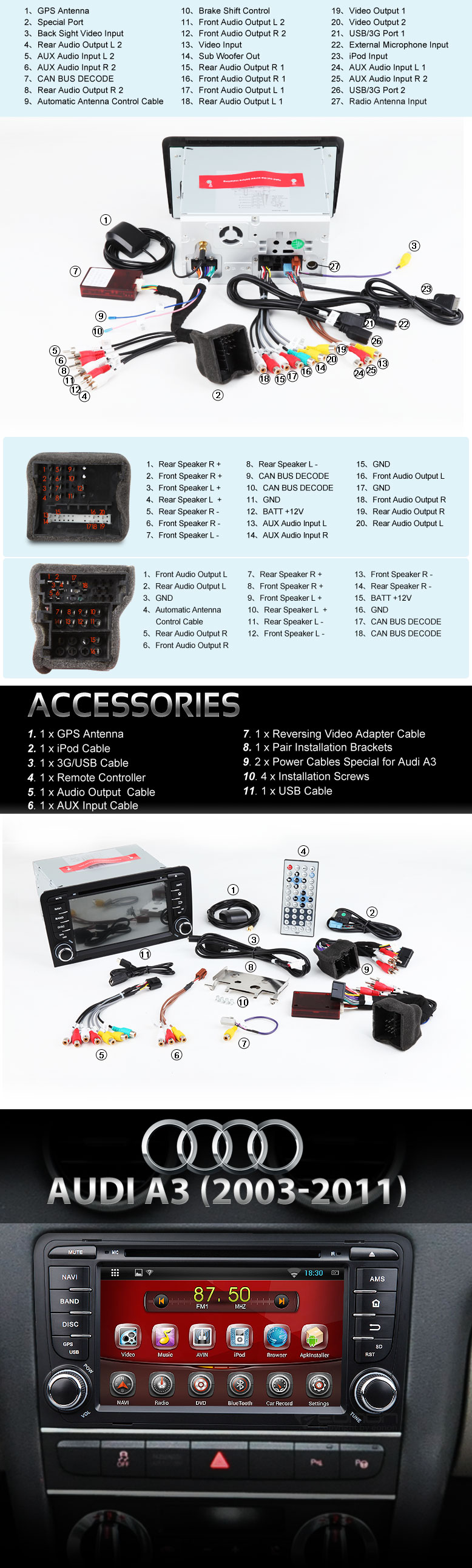

Recently installed an Eonon 5157, Front speakers are working fine but nothing from the rear and sub, any Idea how I could rectife the problem, been looking around and see a lot of people have issues with aftetmarket headunits but can't pin point the exact issue, do I need an extra loom or could it be a power issue?

There's a cable that powers the rear amp/speakers, if there is no power to this from the new HU then the rear won't work. I don't know what unit you removed, but if you look on the label on the old unit you need to find the pin marked "switched positive supply". You have a blue cable on your unit, this should give you 12v with the unit switched on (test it). join this to the "switched positive supply" then join the rear RCA's 4-18 & 8-15 on the link you supplied.
http://www.audiworld.com/forums/tt-mk1-discussion-9/pin-outs-concert-concert-w-bose-1771631/
Look at the above, see pin 6 in plug one, just to give you an idea of what your looking for!

It's the second generation concert i have, here's the link to the pin out http://homepage.ntlworld.com/h5djr/elsawin/radio connections.pdf . I have steering wheel controls and as far as i can make out it has a can bus cable on the new harness as the controls are working fine. I'll take some picture tomorrow of the whole lot so you can see what i'm working with. Here's a pic of the rear from the eonon website for the moment.
Cheers for you help
So I got home from work this morning and took out the head unit to take some pics, after looking at the pin out and the harness for awhile I realised there must be some extra cables that eonon would have supplied, so I went looking in the box that I threw all the cables I thought I wouldn't need and bang there was a rear left and right out cable
hooked it up and bingo all sorted, sorry for waisting you time on something I totally over looked.

Jdsour just noticed by the picture that you have 2 wires coming out of the back of the stereo a blue and blue white wires
just be careful and check your wiring loom normally white blue is normally your switching on wire and the blue is the antenna wire if you read with a volt meter they will both read 12 volts yes they do the same thing but the antenna wire carries a lot less current/ampage than the blue white wire ( I see that the all blue wire has ANT on it any powered aerial must be connected to this wire )

Ok, will check it out tomorrow with a multi meter, should the ant cable be connected somewhere?

jdsour the antenna cable should be taped of if not being used but wrap up with the other cables you don't want a live wire that becomes floating in free air possible catching on the cage and blowing a fuse
