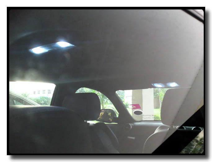

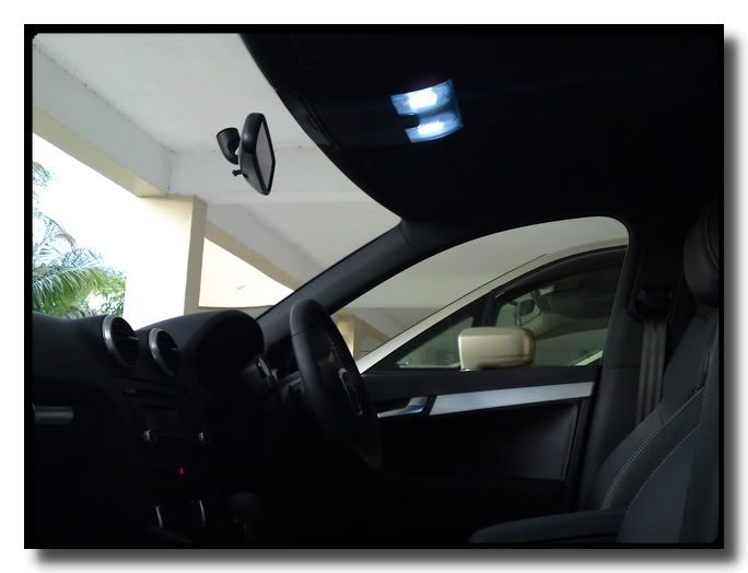

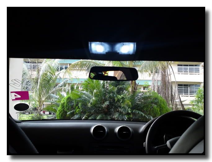

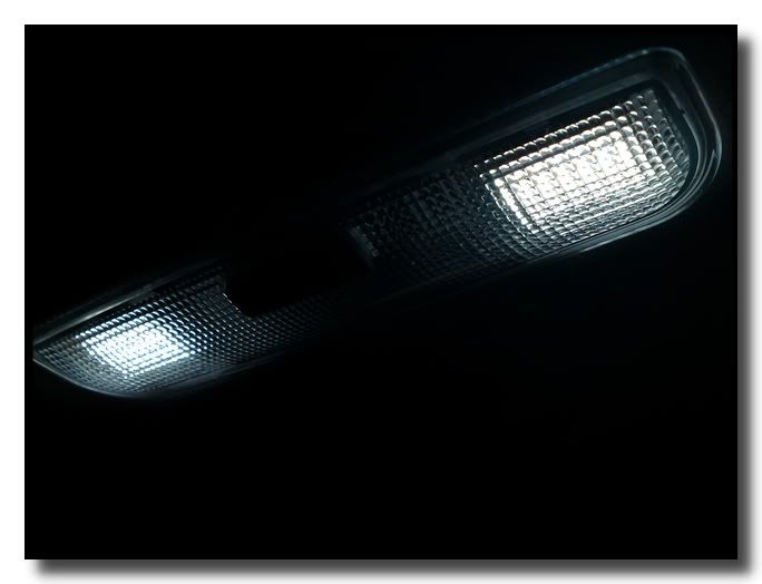

    A little update:
    [​IMG]
    [​IMG]
    [​IMG]
    [​IMG]
    [​IMG]
    [​IMG]
    [​IMG]
    [​IMG]
    [​IMG]
    [​IMG]
    [​IMG]
    [​IMG]
    [​IMG]
    [​IMG]
    [​IMG]

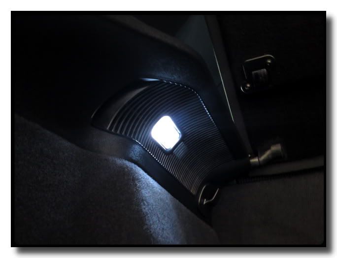

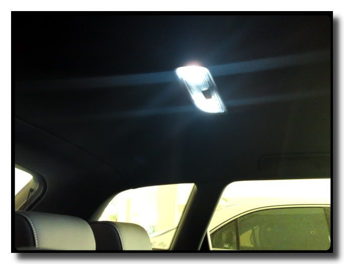

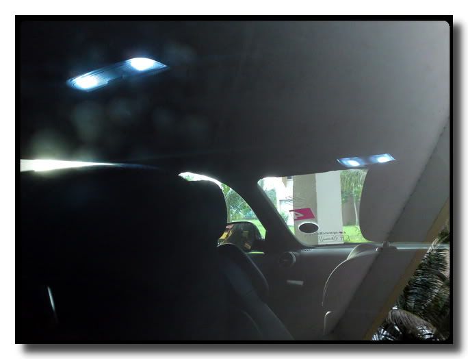

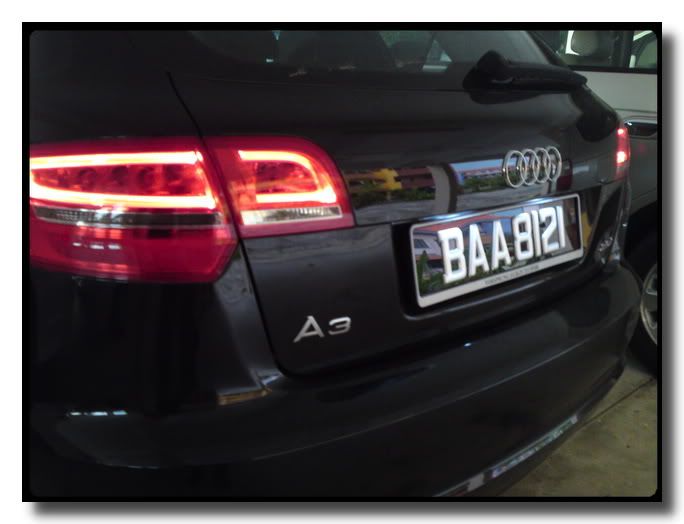

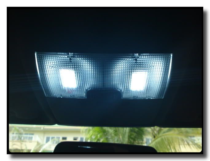

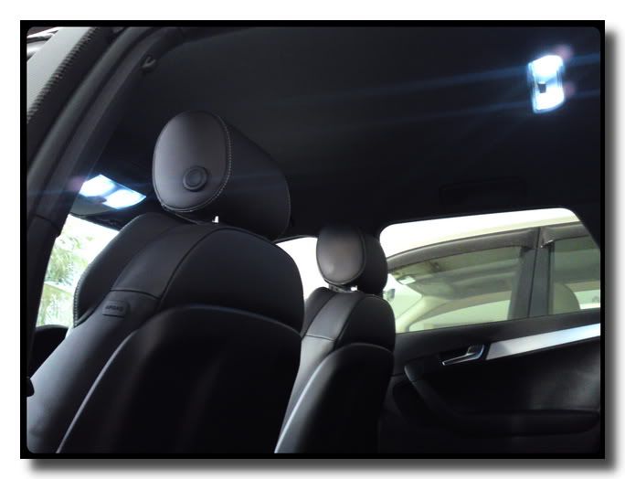

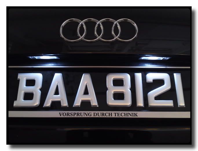

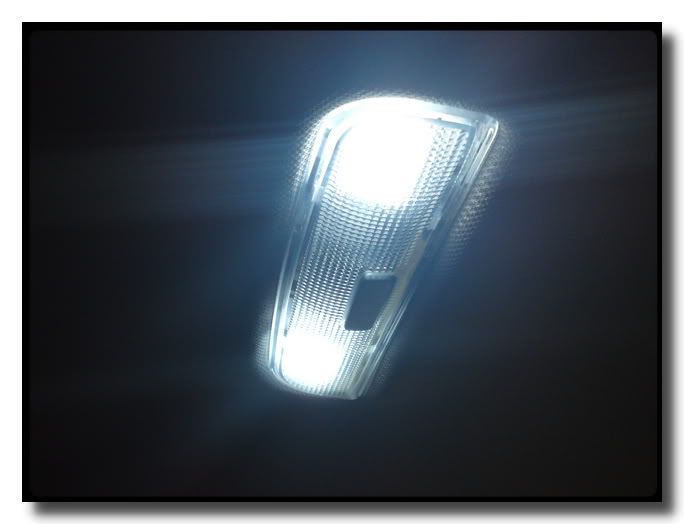

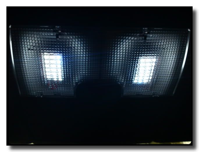

    Interior lamps are from my local autostore. Pretty nice, lots of LEDs and very bright. Blue/white-ish looking. As for the license plate, did the trick with resistors on each bulb (150 Ohms) on Lucid Leds. Purple/white-ish looking.. kinda matches the front DRL LEDs I supposed.

  2. S3 BUH
    S3 BUH Member
    355
    16
    16

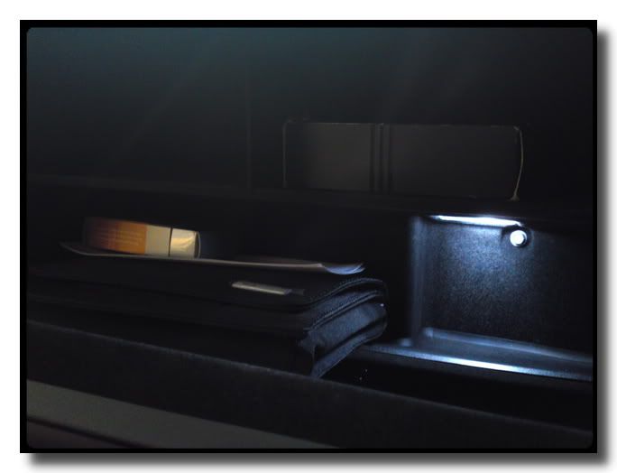

    looks really smart mate great pics , like the glove box LED very useful :icon_thumright:

    definitely looks better! i hate the standard light colour. can u tell me the size of the leds in the glove box and boot?

    Glove box and boot are the same as this one:
    [​IMG]
    And, don't get the Lucid Leds! Somehow, mine turned really deep blue after a 20 minute drive. I was about to admire it and take a peek after I parked when I found that out. Going to change the LEDs as of the interior. Hope it works well.
    Cheers everyone for the comment. Yes! These LEDs should had come stock on these cars. It really sports an "exclusive" feeling while you're in it. :D

    Some night time shots. Notice the rear license plate lamps (By Lucid Leds) are really blue.

    Not the best camera, but you get the idea. Going to change those Lucid Leds so should match with everything nicely.
