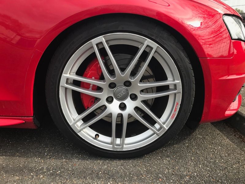

19" 7-arm double Alloys (which I've now swapped to 19" peelers)
Mods:
Front Big Brake Kit - 4 pot Brembo calipers from the A7 repainted in brembo red with decals. This is a direct fit for the B8 S4 and can utilise the standard disc
Centric Posi-Quiet Ceramic pads imported from the US (low dust)
Tarox 345mm F2000 Front Brake Discs
Goodridge Braided Hoses Front and Rear
ATE Typ200 Brake Fluid
MTech slotted rear discs / EBC Redstuff Pads

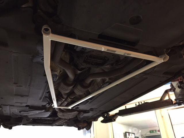

Ultra Racing Mid Lower Chassis Brace
